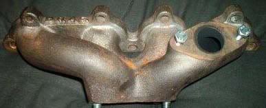

    example
    bad:
    good
    3)if you get a missing like mapsensor bypass and a fmu you will be good for up to 8 psi so you wont have to get a tune but i still highly recomend it!
    4)you have to drill a hole,tap and weld a fitting in!

    thats better because of where the wastegate is located but i have heard of these cracking but never seen it in person. if you take good care of it then you should be fine my brother had one and it never cracked but he let his do a proper 3 min cool down after driving...i have other friends with this manifold and they dont have problems with them either
    and it turns a cool gold color just make sure you wipe off you finger prints before you crank the car up with this manifold!

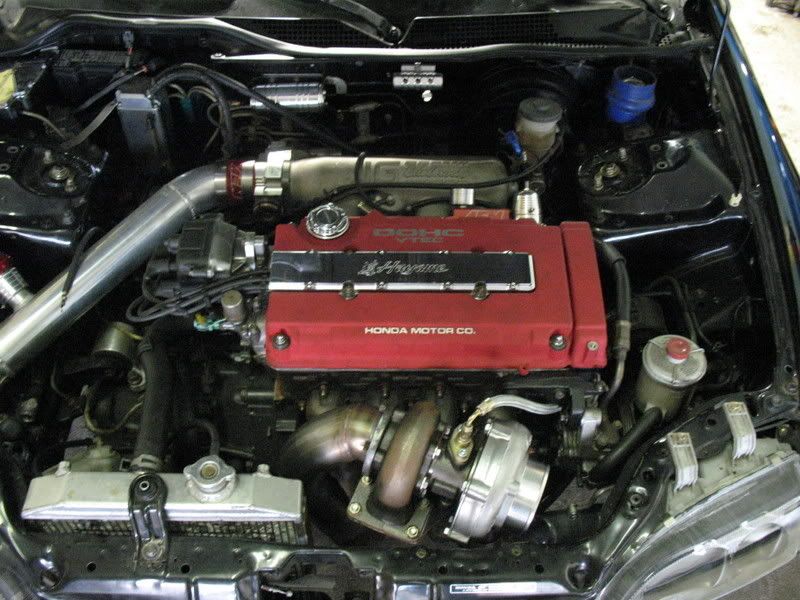

    if i was going d-series turbo i would get this!!
    http://cgi.ebay.com/ebaymotors/SPA-T...Q5fAccessories
    ther is a d-series version i just couldnt find it
    this is what it looks like on a car but its b-series
    and your gonna need a halfsize radiator
    He Alone Is God...Prepare For His VICTORY!!!
