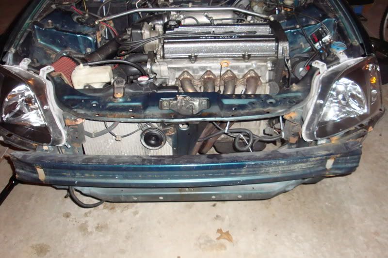

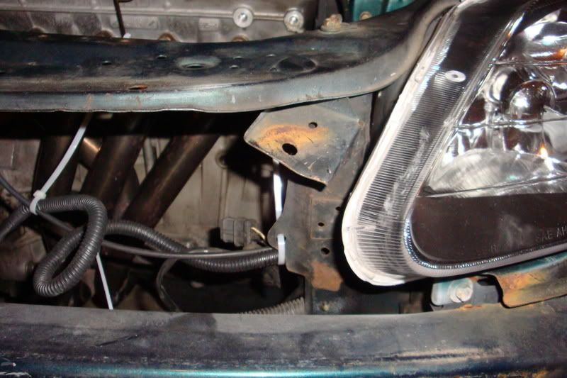

    ok so i just bought this car a couple weeks back and havnt got the chance to align my bumper. so i took the whole front end off and noticed that the bolts were missing at the top of the bumper.. not only were they missing.. the brackets that u bolt it up to was not aligned to the bumper holes. hmm.. any way i can fix this?
    pics will explain.

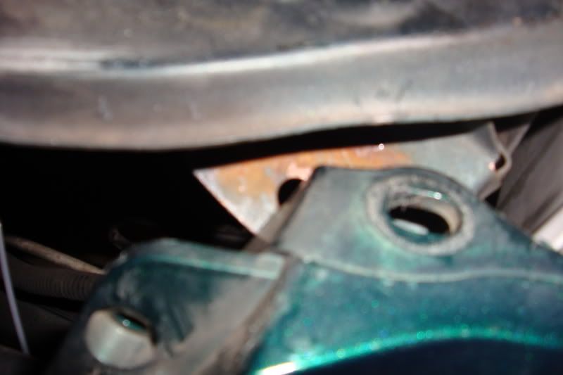

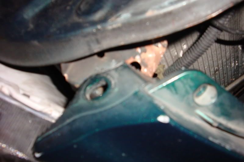

    as u can see, they do not align together.. are they just like that? wat can i do?

    If you talkin about the bracket with the rust mark it seems to be bent a little.Was the car in a front end collision by any chance.?
    3,502
    Good chance it was wrecked. Just get the bumper where it should be then bend the tab to match.

    yea thats what i thought too it couldve been in a wreck. but its a clean title and teh frame is still good.

    lol yah its been in a wreck

    bah, damn.. time to pull out the big hammy and crowbar tomorrow. thnx guys
