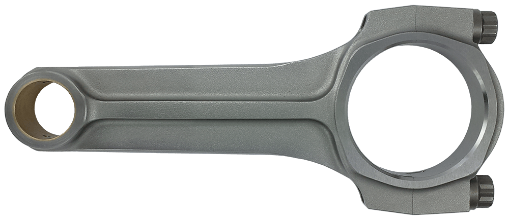

    286
    here's a picture of some pauter rods
    Isolated Twinturbo6's Avatar
    Savannah
    52
    337
    well I am so interested in what your doing as long as you don't mind me, doing the same thing?
    Although if I can find some one to put togeather the TKT set up, it might just as well....
    286
    Quote Originally Posted by Twinturbo6
    double post sorry
    286
    more the merry i don't mind
