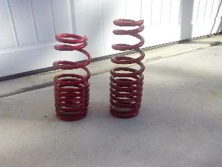

    Bought some used Skunk2 springs, I'm getting ready to install them and don't know which pair go on the front or rear.
    Here is the pic of the different sizes

    lol i think the fatter one goes on the front
    Smyrna
    7,182
    The shorter one is usually in the front.

    look to see if you can find a part number on them or better yet call skunk
    Hiram
    10,412
    Usually one will be a thicker coil, more weight in front of vehicle...

    really depends on the car, what car are they for?
    turbos
    1,296
    right front, left rear.
    but i would call the manufacturer first to be sure

    Look on the springs....There should be a letter and some numbers...The springs with the letter "F" means front and the springs with the "R" means rear...I believe the short goes on the rear and the taller ones go on the front. Correct me if I am wrong. Hope this helps.

    yea what gsrteg said

    Short fat ones on the rear, tall ones up front. that how my teins were, so im pretty postive that yours are the same way

    Installed these on a 95' Integra GSR....
    I tested fitted the shorter ones up front and t\luckily they didn't fit and the taller ones fit perfect. SO the short ones go in the rear and the taller ones go in the front.
