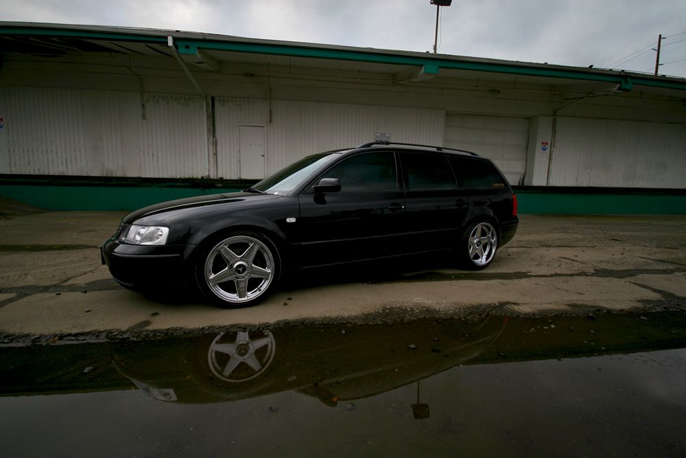

    I have the next gen B6 passat wagon, and love the looks it gets as a modded mommy car. Get it, the 1.8T is easy to make power with, and dropped on wheels they look dope.
    Greg
    86 Buick GN
    07 Passat Wagon
    01 Frontier
    Senior Member jfman's Avatar
    1,865
    ^^^^^^^^^^^ PIX or GTFO
    old school fool Allstar3.8T's Avatar
    Loganville Ga
    53
    1,625
    Quote Originally Posted by jfman
    Here you go....
    Attached Thumbnails Attached Thumbnails -picture-006-jpg   -picture-007-jpg

    nice!
