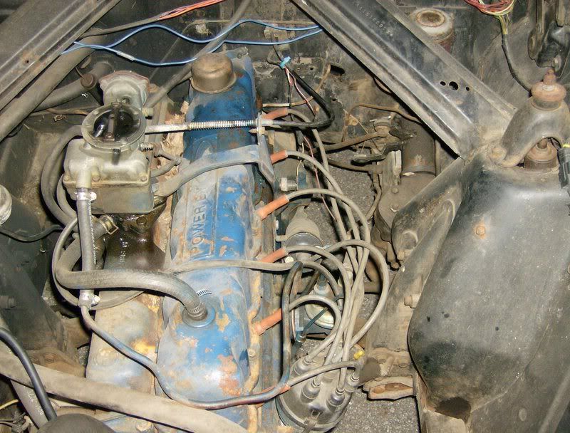

    More about the car... its a 1962 Ford Falcon. I just finished rebuilding a 1978 200 straight six engine for it with a mild cam upgrade and a little more compression. The car originally came with a 170 six. So the extra 30 cubes (plus about 6 more from boring it 40 over) are a nice improvement. The car also has a C4 automatic.
    As it was when I bought it: points ignition, 12v generator, FUBAR shift linkage and a whole lot of dirt.
    Seeing how dirty everything is in that pic you can imagine what was in the cooling system. You know its bad when you drain the coolant and dip a magnet into the bucket and the magnet comes out covered in rust

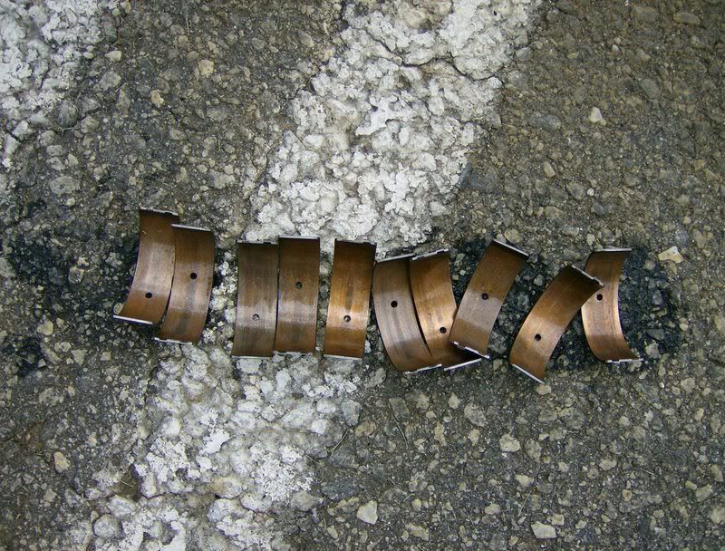

    These are the rod bearings I pulled out of the above engine, worn all the way down to the copper (I used another engine for the rebuild... the one these bearings came out of was scrapped)
