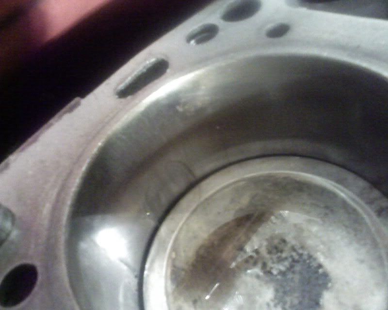

    I pulled the head completely off and inspected the #4 cylinder as I had felt around it before and it seemed to have some cracks in it, so I thought the block cracked.
    Here is what I saw when I got the head all the way off.
    So here I can tell something has went bad and wore a nice spot in the side of the cylinder wall. Not good.

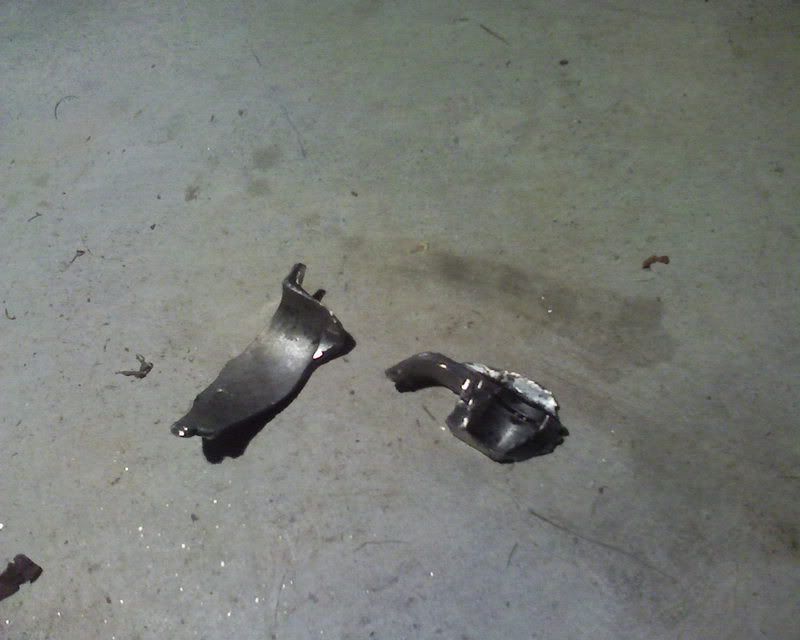

    I finally got the oil pan off after the draining and pulled these lovely jewels out of the pan.

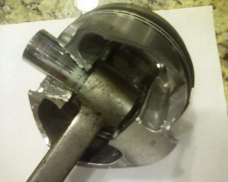

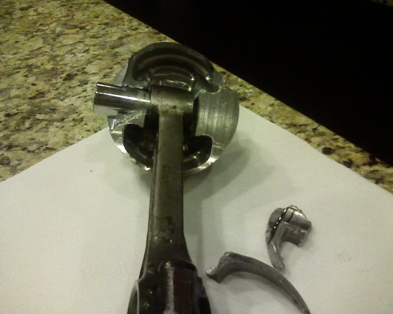

    Then I got the #4 piston out and low and behold the culprit showed itself
    I guess now I know what that knocking was that I couldn't find. It must have been a loose wrist pin or something and then when i got it to highway speeds it gave out. Now I have to start all over from scratch. I am tired of this motor and I haven't even got to drive the car but a couple times for a few minutes. I want to pull my hair out. Now what do I do? I guess back to the drawing board.
    Do you think I can trust the other 3 pistons? Is there a way to verify they are sturdy enough?
    I will tare the rest of the bottom end down later but for now I guess I will need to collect some new parts before moving forward.

    IMO, do it right the first time. you dont want to just fix #4 and put the whole motor back together, then #2 takes a **** on you or something like that a week later. while you are at this stage, go ahead and check the rest of the motor out. just my

    I would not have the other 3 checked. I would go ahead and ditch them and get a whole new and balanced set together. Getting the three you have, plus a new one, could cause balance issues. Sucks to be in the position you're in, but one of two things must've happened here: You made a mistake, or there was a flaw. If there was a flaw in the product, go back to where you got the product from and see if they're willing to take care of you. If you made a mistake, then I guess it just sucks.
    283.5°.516"(13.11mm) DirtyMechanic's Avatar
    Alpharetta, Ga
    4,086
    sounds like the wrist pin wasnt matched to the pistons... i highly doubt now the other 3 "good" pistons have the right wrist pins... ditch the pistons and start again... its hard to do but its the right thing to do...
