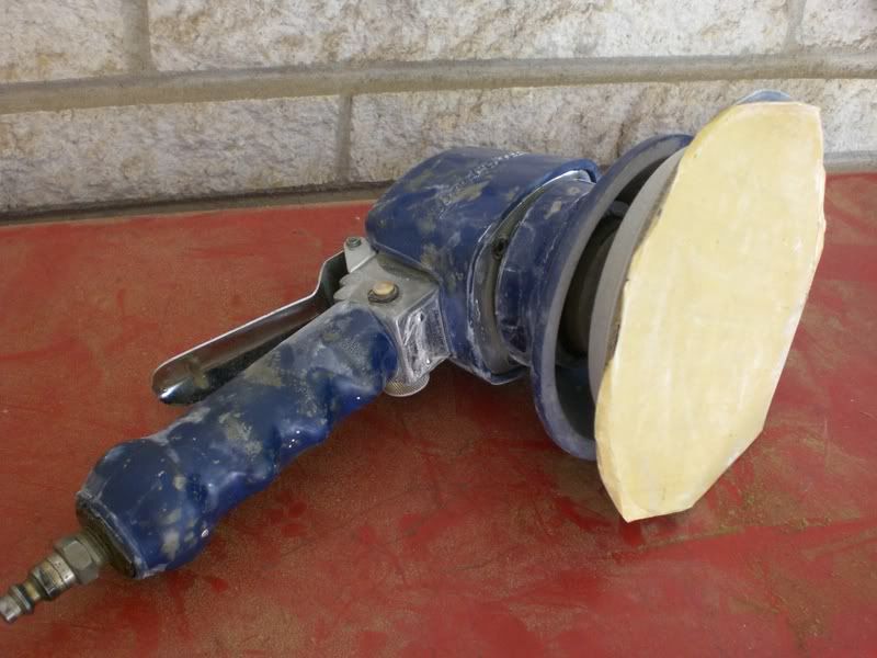

    2.--6" DA(Dual Action sander)-*note mines not from Harbor freight*
    $19.99 Harborfreight
    http://www.harborfreight.com/cpi/cta...emnumber=90288
    Or PREFERD $29.99 for easy palm sander
    http://www.harborfreight.com/cpi/cta...emnumber=93742

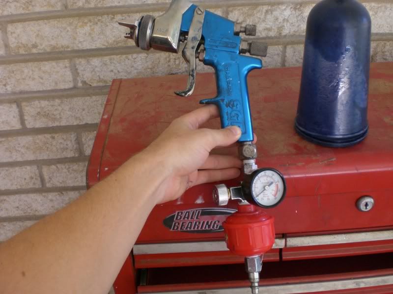

    4.spray gun;Gravity feed,pref. HLVP
    MINE; Sharp SGF-HLVP (1.4mm tip)
    cheap harbor freight ones will be fine:
    http://search.harborfreight.com/cpis...+gun&Submit=Go
    *Note- Air pressure reg. with gauge-$4.99
    http://www.harborfreight.com/cpi/cta...emnumber=36797

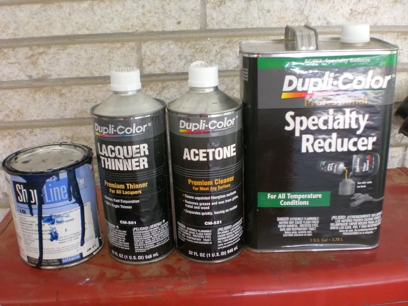

    now onto chemicals;
    Paint- I used shopline-decent color match is a SHADE darker then bumpers.
    i got a quart mixed up.for whole car i would say get 2quarts for errors ect.(will have left over)
    then advanced for-
    Specalty reducer, Laquer thinner,Actone
    -then to finish master(autocolor) for clear coat kit- I used there SMART kit.
    gallon of clear, Medium activator.-$66 and some change.
    also picked up 2 mixing cups- .34cents each-
    they throw in paint sticks and strainers for free!

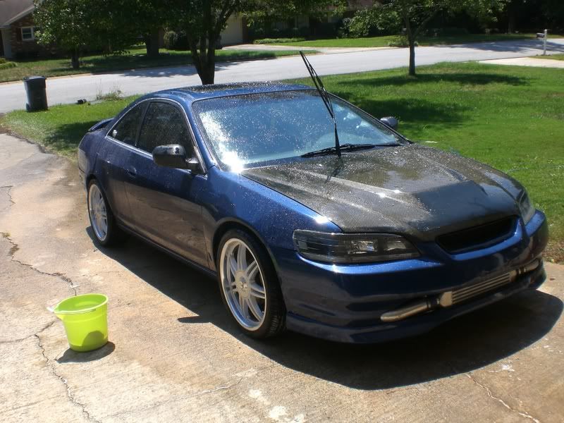

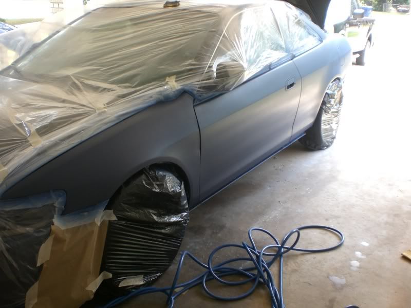

    1.You want to go ahead and give your car a quick rinse off using dishwash soap like dawn or something. Then dry off.
    2.put a car into either garage, or in my case car port.-Make sure its ok with neighboors,parents ect before starting.It is against the law to paint with out proper ventalzation..shhhh..
    3.Take off bumpers,mirrors,headlights,tail lights, ect-OR tape them off really good!!

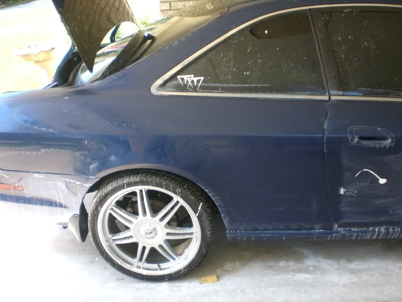

    4.Get out the air compressor and DA..if painting new color or full over.then get your 400gritt paper and go to work! carful of the edges since if goes through to metal or something the color will be slightly off on those areas.
    -Once you are happy with sanding everything down-blow off the lost dust(i used my paint gun.lol since i dont have a blower)
    -get all the lose dust off the car from cracks,door jambs.ect.
    -Get out your prep wipes or wax grease remover and give it a nice rub down.
    5.Tape off all the edges,window moldings,ect(if not taking off)
    -Tape inside the door jamb,both on car and actual door.
    -Tape the back edge of fender and hood area right there
    -Tape inside and cover gas cap with newspaper and tape!!!
    just general tape off everything you need.-MAKE SURE NONE IS TOUCHING WHAT YOUR GONNA BE PAINTING OR YOU WILL GET A TAPE LINE OR spot where the color is deff ect.
    6. you and or a buddy get the husky drop cloth out and start taping up the car-window,roof,ect..if doing all over then use the masking paper and tape up the windows and leave what you want painted open.
    7.Once everything is taped up and your happy and are ready to spray. go over it again with the blower,and wax grease remover and tack cloth.

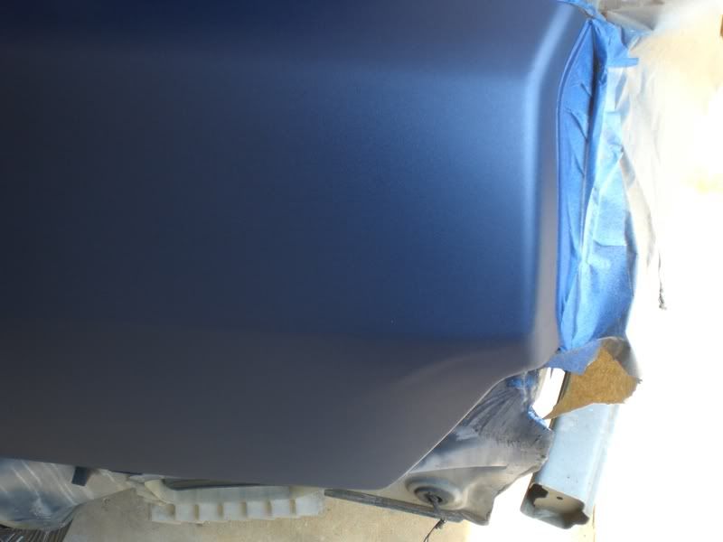

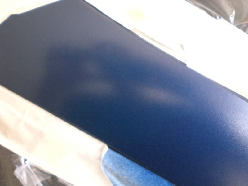

    -the base color is just to get the color-NO shine will be from this.do not run the color, all you need is a lightly dust over it
    -Wait atleast 10+mins inbetween coats(follow paint directions) need atleast 3.
    **in between coats wipe the panel down with the tack rag again! keep the bugs,trash out best as possible.
    11. After you are happy with the coverage and base color let it sit for 15mins for the solvents to escape. tack rag again.

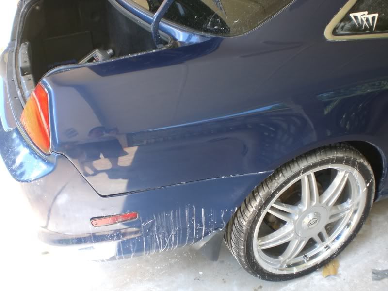

    13.After you lay a good 3 ful wet coats of clear, leave it over night.(or when ever it dosnt feel tacky before start sanding)

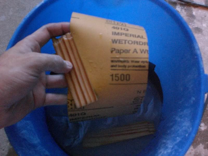

    14.The next morning go back out and get a 5gallon bucket or something to hold water for wet sanding! soak the paper in the water for 10mins before starting
    -get out all your wet sandpaper packs and any left over paint sticks.
    -break the paint sticks in half

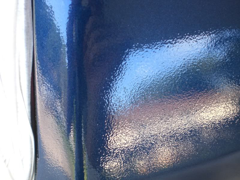

    -depending on orange peel or trash is what determies what paper you want to use.. normally just start off with 1500g and go to town.
    --but since mine was so bad: i started with 800G and worked up to 2000g.
    **NOTE do not skip in grits. (800g,1000g,1500g,2000g,)

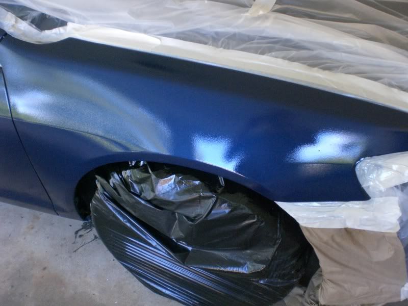

    *note your car should not look this bad if proprly set gun! but if it does..dont worry itl be fine-just ALOT more work sanding.
    -General rule of thumb is find a happy medium when sanding.not unless you are looking for show quailty then sand baby butt smooth,if not then some texture is ok-due to ALL cars from factory have orange peel.
    -as some say,Sanding is not for the faint of heart,touching your freshly painted car with sandpaper thats wack! but no-its the most important step in getting what people say as slick as glass feeling.
    *also sun reflects better with the flatter the paint is,cars with orange peel the sun dosnt reflect as well and you notice the blobs.*
    -Take your time getting trash,orange peel out. It took me 1hr+ per panel.just dont give up..its well worth it.

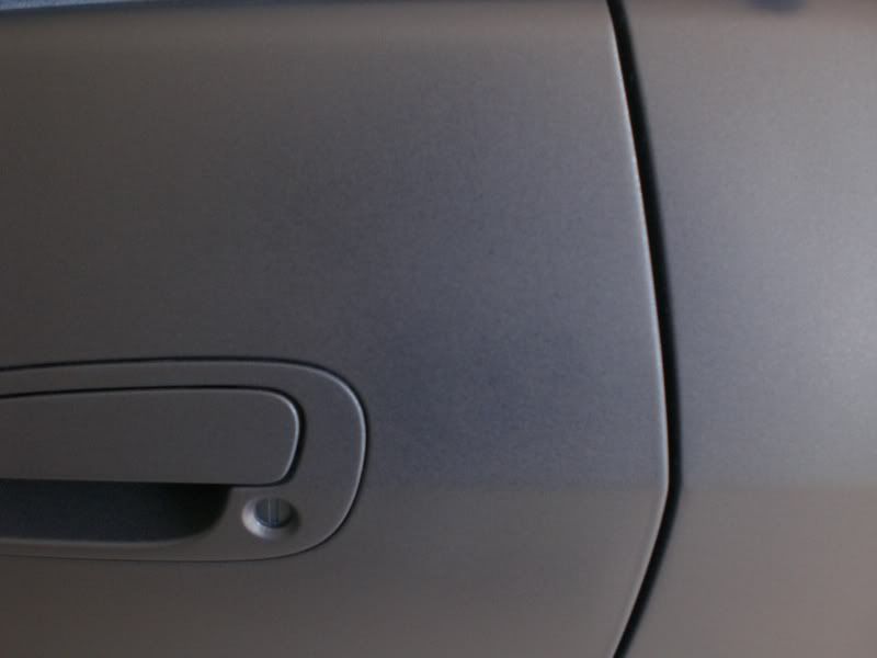

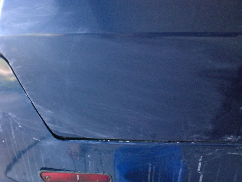

    -after you sand it down,you will have what looks like a ghostly white car with the color barly showing behind it.dont worry!!
    follow the pics below to show the result after wet sanding.also very messy.
    -Wrap the sand paper around the paint stick;
    sanding always keep area wet! have a rag to put water on panel to wash away trash and residue.

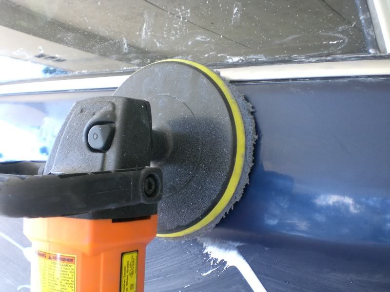

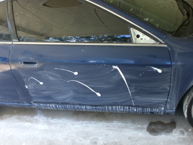

    -Get your buffer out and grab the WHITE foam pad and RUBBING COMPOUND. work it slowly-this is very messy and gets everywhere!!!
    -keep the buffer flat and KEEP IT MOVING!!! try to stay away from the edges for long period of time.and also do not keep it in one place,you can and will burn through the clear/paint and cause it to bubble up.
    *so this part is NOT for everybody to attempt..serious damage can happen from this stage to your fresh paint.*
    -as the foam pad spins on the paint and the compound, a chemical reaction happens and heats up-getting rid of the scratches and brings the paint back to somewhat of shine. do this till all scratches are out and its not dull anymore.
    wipe off the residue with a CLEAN micro towel.^ **photos show both compound stage and polishing stage.**
    Then you are left with this;
    you notice you have white compound spattered everywhere,loaded up in the cracks and jambs.-I told you its very messy and time consuming. You are almost finish=

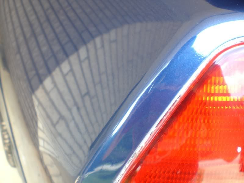

    -Then get the gray pad and polshing past...do it the same way as compound. this will remove lighter scrathces,and will bring the shine back into the paint..also some polishes are swirl removers as well-make sure you get that or you will have those ugly swirl marks you see on black cars-No offense- haha
    http://www.youtube.com/watch?v=5DyXplehnhw

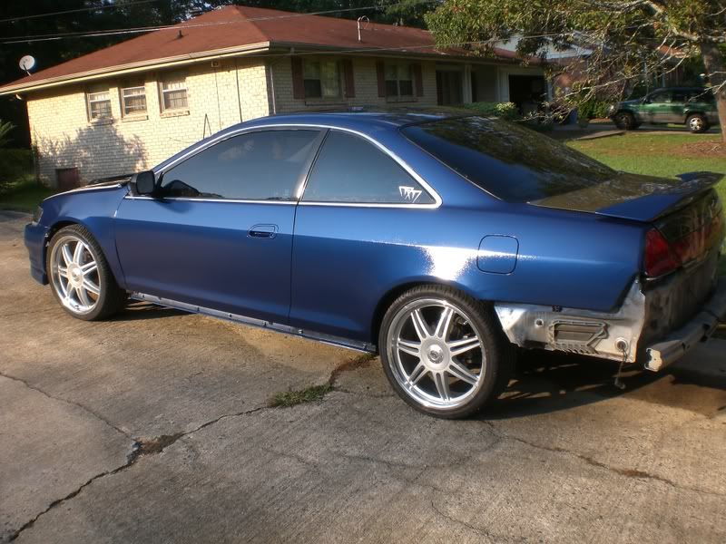

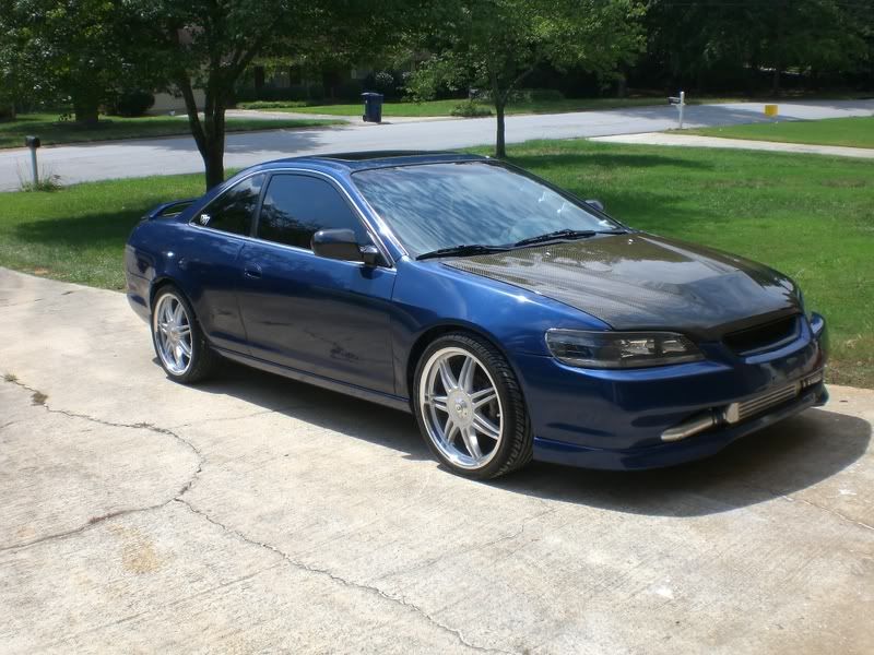

    results of hours of work and cheap paint job!
