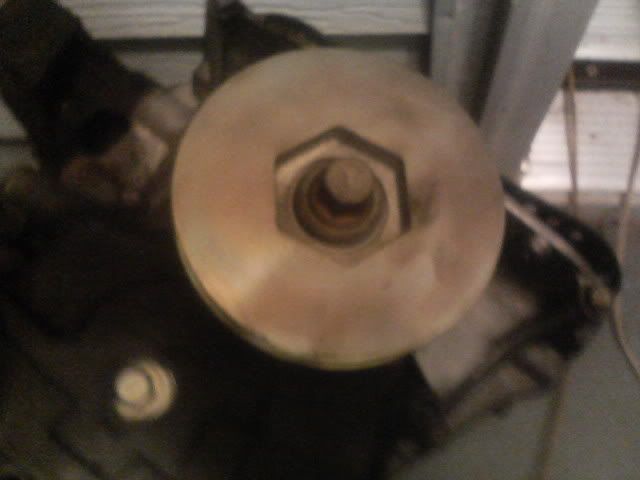

    If this helps here is a picture of a crank pulley on a B16 I have. I dont think I would use it.
