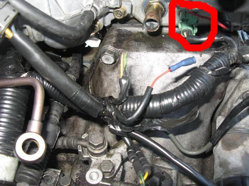

    i was just installing my Wire Harness. Everything Went all good till i saw this greenish sensor just chilling there. it has 2 wire coming out from it and its green/white line and Yellow/Blue line. the sensor is greenish color. can anyone tell me where this sensor goes or whats it for? It got cut off for some reason.
    The Sensor is near the Dizzy. Right below it and it dosent stretch that much.

    vtec solenoid connector ???? i see the vtec solenoid is not connected .

    yeah i thought so too. it fit right onto it. but its from a H23. and they dont have vtec so im pretty sure its not for it.

    Thats what i thought too first. it fits right onto vtec and **** but the wiring harness is from H23. there non vtec.

    it comes out from the same place as the External Coil for the dizzy.

    Quote Originally Posted by G.C
    after looking at 2 diagram thats all i can find.

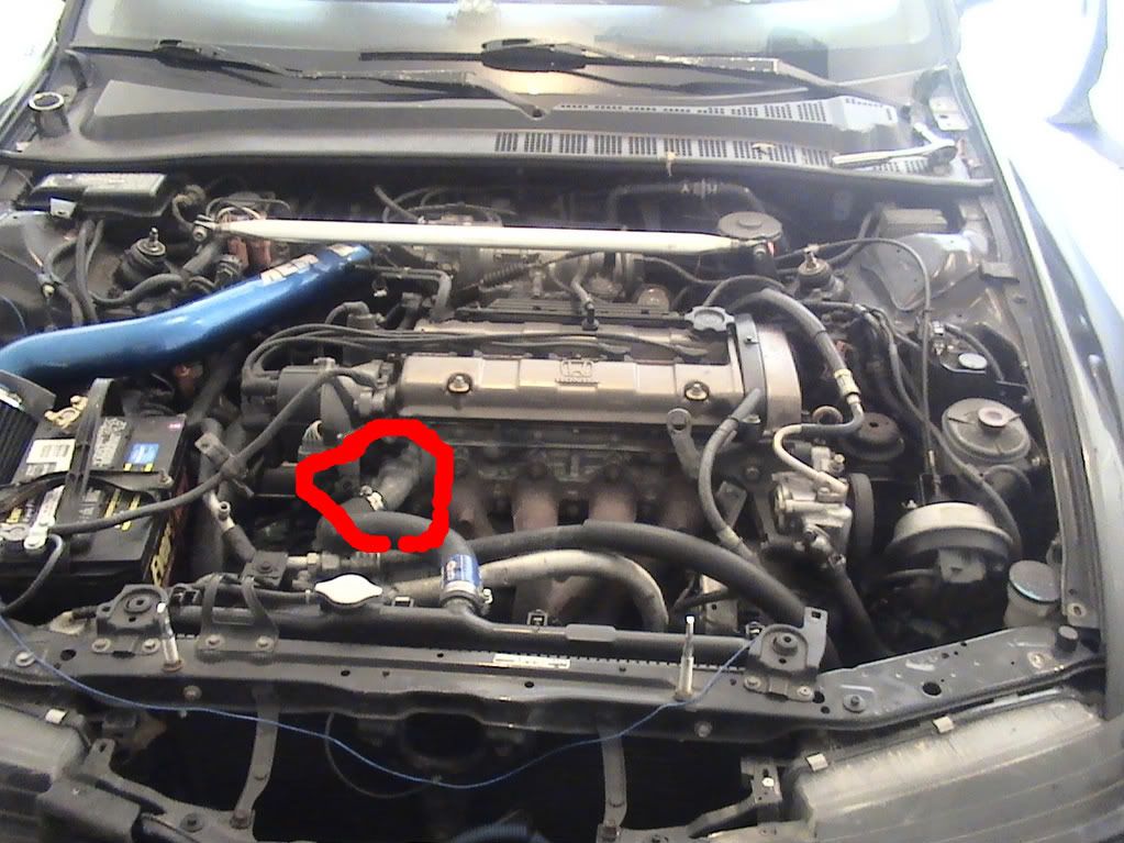

    no it isn't apart of the external coil wires to small (ninjas away from the computer and runs outside) the green plug you have here goes to the pic below.... and the mystery sensor goes where the green plug is.... the jdm h22 didn't come with a fan temp sensor on that bottle neck

    thanks.!!! i cant really tell where the green sensor goes tofrom the 2nd pic but i'll look around that area and try to find it. Thaks Alot.reps given.

    there is no where else to plug this green sensor to. the 2nd pic where its circled at. has no where to insert the connector at.

    if you look closly to the bottle neck you can see the sencor to the left, the jdm h22 doesn't have on for some reason
