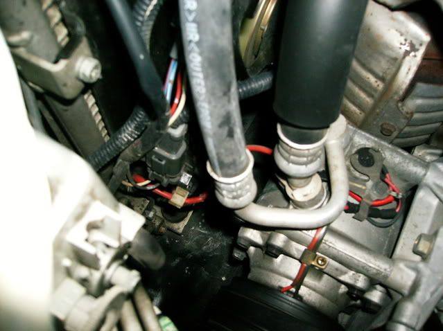

    okay people. im making an attempt to bring my ac back to life. it looks like i have all the parts there, but theres a plug coming from the compressor that is unplugged. its a red wire with a plug on the end.
    i talked to a friend of mine & he said its supposed to plug into the driver side on the condensor. but i'm not seeing a plug on mine.
    so! if you could help me out & go take some pictures of your AC setup it would really help me out! =) or if you know exactly where this stupid plug is supposed to go, that works too! =)

    Here this is one of mine, it goes into some harness right under the driver headlight

    The condenser doesn't have any plugs on it, just a/c lines. That plug coming from your compressor is what powers up the compressor. It's counterpart is somewhere on the chassis harness, usually located near the condenser as the pic above shows.
