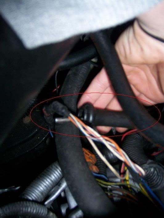

    JDM TYTE AnthonyF's Avatar
    Cumming
    24,318
    61
    how much is that whole setup? Compare that price with a full B series swap's price. B series is where you want to go. Swapping a D for another D isnt much of an improvement.

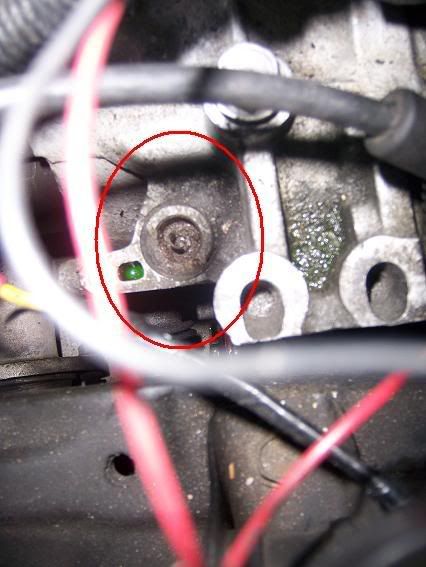

    Look whats inside my tranny.
    Where the speedo cable goes. How the **** can I get that piece out???

    is that a portion of the actual cable VSS thats broken off? It can still be removed but you'll have the disassemble the trans.
    All Motor EK N/A EK's Avatar
    On IA.com
    7,247
    Quote Originally Posted by green91
    Yeah its a pieace of the cable, well actually thats what it looks like lol.
    Mountain man green91's Avatar
    May 2003
    Dahlonega, Ga
    8,975
    The transmission actually has a piece like this that bolts on and is driven by the differential, and your cable actually slides into this piece.
    im saying you should be able to unbolt that and slide it out and then either replace it or get the cable out of that.

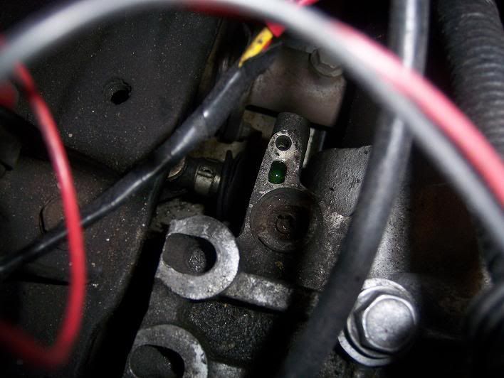

    Here is a pic that I just took of whats down there. This shi* is all rusted
    May 2003
    Dahlonega, Ga
    8,975
    i think that the VSS is actually broken off into your trans.. it will require trans disassembly to get it out and it may not even come out, have you ever taken a trans apart before?
    On IA.com
    7,247
    Yeah a few of them. But not on a honda.
    May 2003
    Dahlonega, Ga
    8,975
    From that pic it looks like the vss shaft is broken off inside the trans case. Youve gotta pull the main/countershaft, shift forks and diff out to even access it, so its a pretty heavy job but not to bad if youve got trans experience.. if the shaft is seized into the case though its probably gonna be hell getting it out
    On IA.com
    7,247
    Yeah I know, see thats why I just wanted a new tranny so I dont fu*k with this sh*t.
    May 2003
    Dahlonega, Ga
    8,975
    Yea sorry i didnt understand exactly what you were working with. But definitely stick with another cable trans and get the d16z6.
