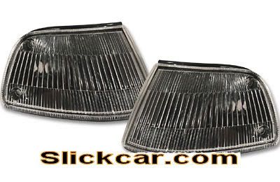

    also, where can i find corners like these
    for a 89 crx?

    The jdm corners look like those kind of.

    so can anyone tell me where to find those corners?

    lol , slickcar.com?

    Quote Originally Posted by TheScotsman
    lol , slickcar.com?
    ha yea i looked there. they have the ones i want but theyre for 88-89 4dr EF.
    i really hate the black housing ones on ebay. i want something oem-ish
