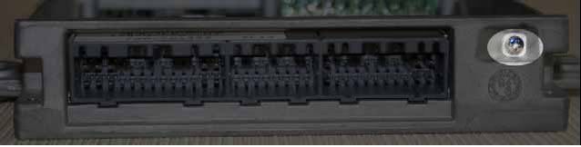

2> Remove all screws holding the circuit bored in place, and loosen the screws holding the main voltage regulator to the case.

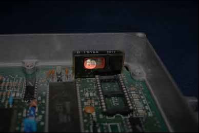

3> Remove the circuit bored, and use electrical tape to cover the small hole on the barometric pressure sensor.

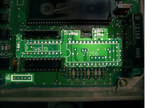

5>Once clean, Desolder the items outlined in this illustration:
6>Remove J12 (or J4 for JDM ECUs)
7>Solder the following components included in your kit to the indicated location in the ECU.
ECU location:
27256------------
74HC373---------(CMOS Latch)
27256---------(28-pin DIP socket)
CN2 (Pins 1 - 4)------(4-Pin Straight Header)
R54----(1k Resistor)
C51 & C52---(.1uF Capacitor)
J1----(Red Jumper Header)
27256----(28-pin ZIF socket)

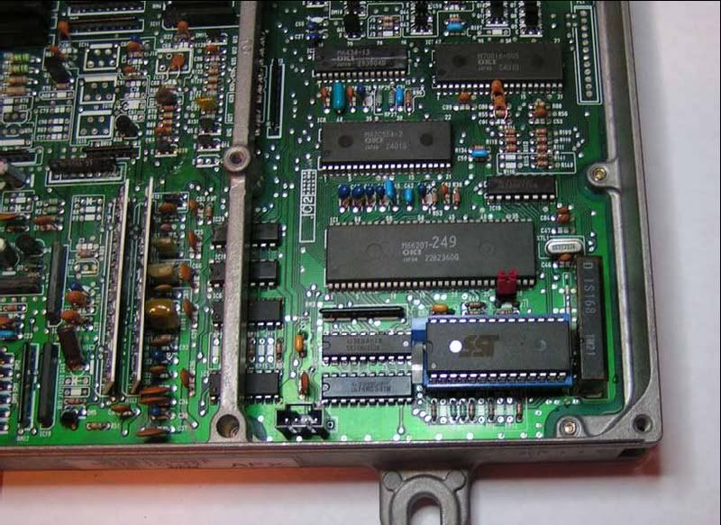

Finished product
(CMOS Latch)
(28-pin DIP socket)
(1k Resistor)
(.1uF Capacitor)
(Red Jumper Header)
(28-pin ZIF socket)
