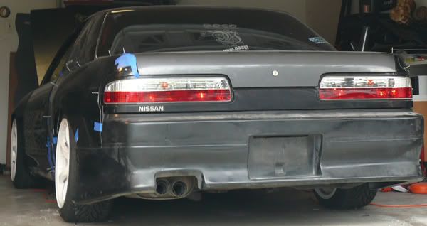

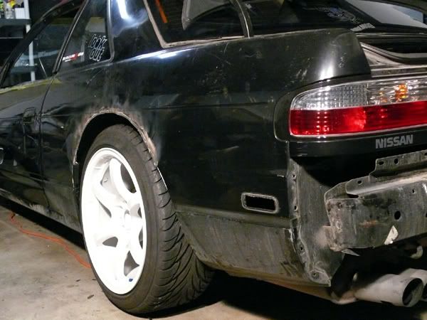

    Stole this pic off zilvia, 17x9 +17
    4 degrees of camber
    ~10mm pull
    25mm spacers
    215/45/17
    Please search next time, if you are trying to find something about 240sx's, go to some sites like nico and zilvia. This picture is off page 2 of the wheel whore fitment thread.
