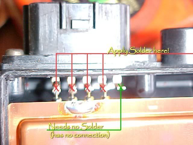

    inside you will find this: this is where the soldering comes into play, put some solder in the areas I have marked. Don't worry about old solder, mine just burnt off anyway. I am not sure what the 5th connector is for, as it has no internal connections and therefor needs no solder, it wasnt from the factory apparently so yeah.
    Try not to get one spot too hot, not sure what kind of damage you can do but I would just assume you can/will. Once you've soldered every thing back up, maybe blow the inside out with compressed air if you'd like, and replace lid and make sure you seal it with silicon or something. Im sure moisture is not good for the insides of a maf.
