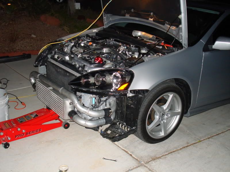

    ok i got a FMIC with single sided endtanks that i want redone to a more normal style. wheres a good place to get this done? I'm also going to need some more 2.5" aluminum piping and maybe some couplers/tclamps too to extend the charge pipes to the other side. any recommendations would be great.
    heres a pic of the FMIC now, precision 650hp core
    i want it similar the greddy so that a 180 curve in piping isnt needed but i dont expect it to be JUST like that lol
    but if cant do something similar to that this would be ok i guess

    Since you have to route your charge pipes like that anyways, why not just leave it as-is? That seems more logical to me, save yourself some $$ as well as maybe a little lag...that's a 180* turn and 2 feet of pipe no matter how you slice it.

    is it not going to hurt HP since the FMIC is basically cut in half? and wont it kill flow greatly with such a sharp 180 (inside the core)?

    I wouldn't think so, because you're going to have a full 180 bend no matter what since our TB's face the driver's side, so instead of doing it with a pipe, you're doing it internally. Like I said before, if nothing else you're going to save money and possibly a tiny bit of initial lag, but also, if you think of it the air is essentially making two passes through the intercooler, so there could be some added cooling benefits. I don't know, though. To answer your original question, though, if you want to have it modified, I say call turbo dave up at mainstream...he should be able to take care of it.
