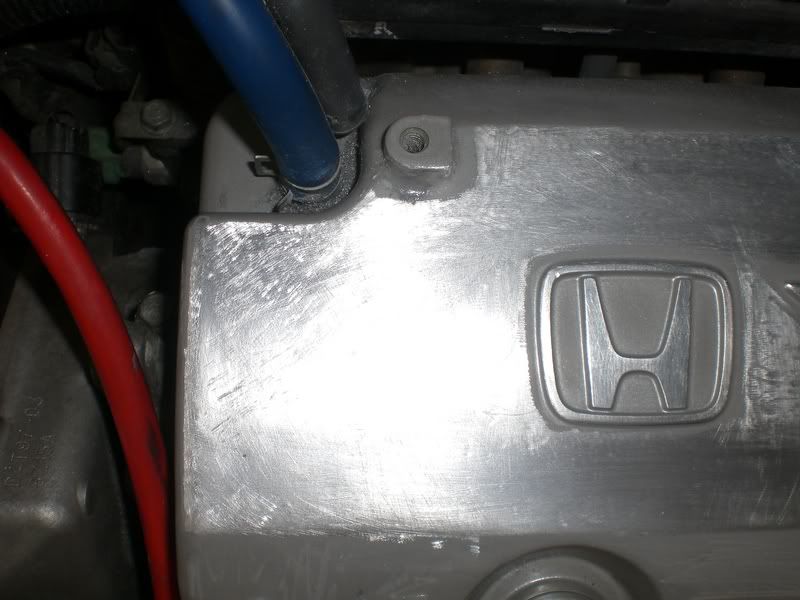

    ok so heres what a dremals done for me so far..im gettng my girl to bring me the 3" small da so i can make life a lil easier and faster with air power.
    shinner,but scratches. ^^ are with 80 &60 grit
    having a hard time getting in between the letters and ect.

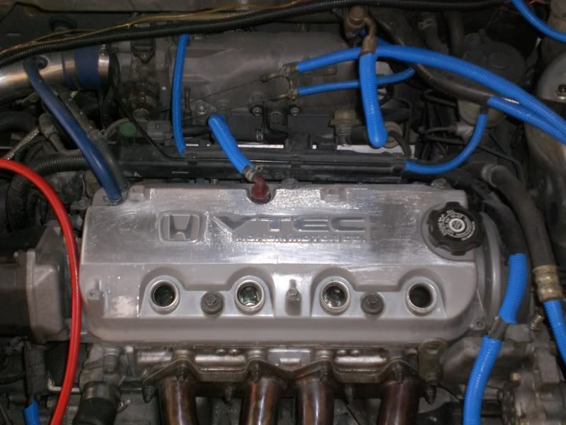

    i didnt want to drain my oil and everything..i got really bored today so i decided to polish my VC.lol
    what i ended up doing was getting my 3"pistol grip DA and got it done..pretty decent.for the papers i had..80,180,600,1000.lol but it shines enough.wasnt trying to get it perfect.better than wat it was
