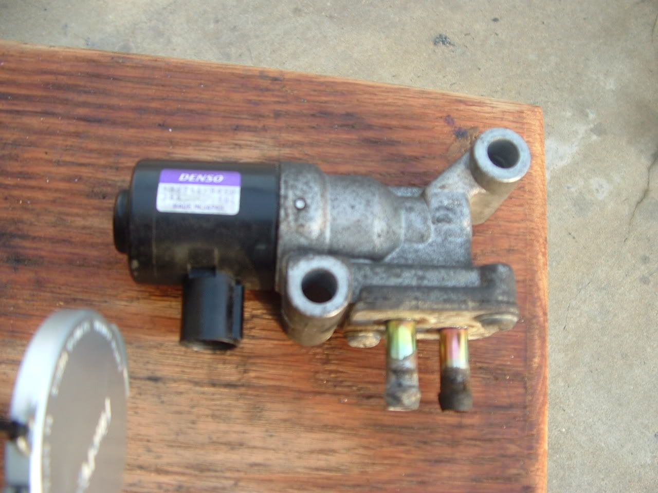

    Senior Member SLow_POke's Avatar
    WEST_SIDE
    1,841
    what ur looking for

    Default Yeah thats it!
    Quote Originally Posted by SLow_POke
    what ur looking for
    Thanks man! I needed a picture

    Yeah I took it off and the screen was kinda cloged with black dirt or what ever. I hope that cleaning it with denatured alcohol was ok cause I did! Yeah these are $245 at the parts store! Sux! Its so little! CAN I SPRAY CLEANER INSIDE OF IT?
