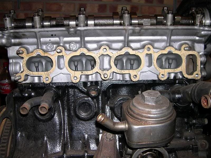

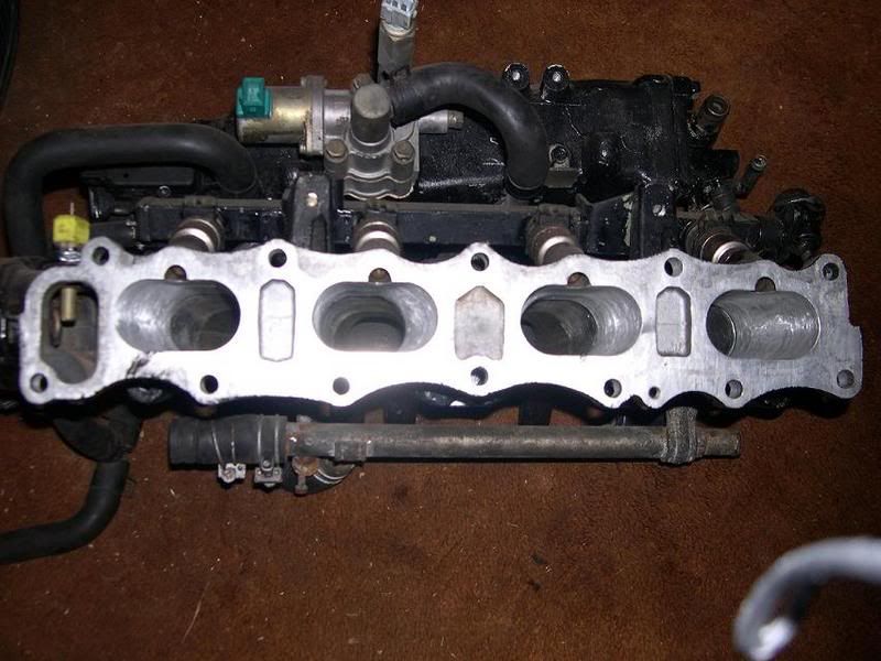

+1 and good post, and I'm probably gonna get flamed for this, but:Quote:
Originally Posted by Mooney1184
I don't see why people like the butterfly valves in the J-spec CA. I've seen UK-spec CA's do some serious damage on and off the track, and they have a 4 runner-4 port design. None of that butterfly stuff. Shit, the highest hp CA18 outside of Japan is a UK-spec S13.
I dunno, I just think this would flow better than splitting it into 8 ports. Not to mention that damn near every CA I've seen w/ the head/intake mani off is gummed up behind the valves.
http://img.photobucket.com/albums/v6...keManifold.jpg
http://img.photobucket.com/albums/v6...ntakePorts.jpg
