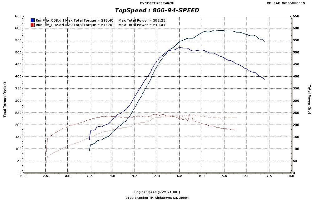

Mods: PE850cc injectors, Topspeed fuel system, Perrin fuel rails, Topspeed GT35r kit, tilton clutch, TXS catback, Perrin FMIC, Crawford S3L block, Hydra EMS.
This car is still on stock intake, stock heads valves and cams. Boost was set at 30psi all the way to redline, I am sure if it wasn't so hot (95F) in the shop today DOUG could have broken the 600hp mark.
Pictures and Video coming soon.
