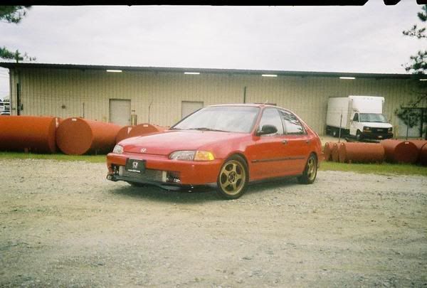

    i had a z6 with a hf manifold and a 14b and i ran a 13.0 @ 106 on drag radials that was with a stock motor on 14psi

    I really like that set-up . I was definitely going to use the HF manifold and adaptor plate. I only want to run about 6-8 psi, even though I have learned from ScttyDB that with the proper A/R mixture I can run 12-14 psi. I want to keep the set-up kinda stealth so even though the SMIC is small I believe I will use that intercooler. I believe it should hold up as long as I don't go above 12psi, which is I belive what the wastegate is set up for on the DSM's. More, more.
    "...you say that because" redciv1's Avatar
    638
    you know the more I look at your 4dr. the more I likes. I might have to look for a 4dr. instead of the 2dr. I had.

    i liked the 4dr alot i wish i never had sold it

    It's so much fun kicking someone ass in a fourdoor.

    hahaha yes it is especially in a sohc

    Did you do all the work yourself d16. I figure I can take my time with the rebuild of the engine since I have always wanted to rebuild just one engine. Do you still have the turbo d because I would like to see it when I finish the H22 in the Accord.
    warner robins
    1,535
    i did all the work my self but i already sold the turbo kit and the motor a while ago , but if you have any questions just let me know

    Clean Little car...The turbo One. You still have it for sale.

    no i sold the motor and turbo kit and then i traded the shell for a 97 civic hatch
