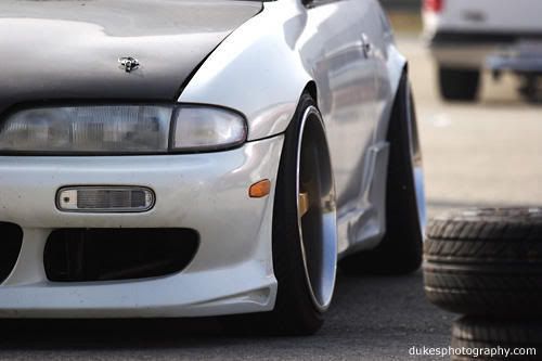

    lol well baseball bat was able to do this...
    thats not all that ghetto looking lol
