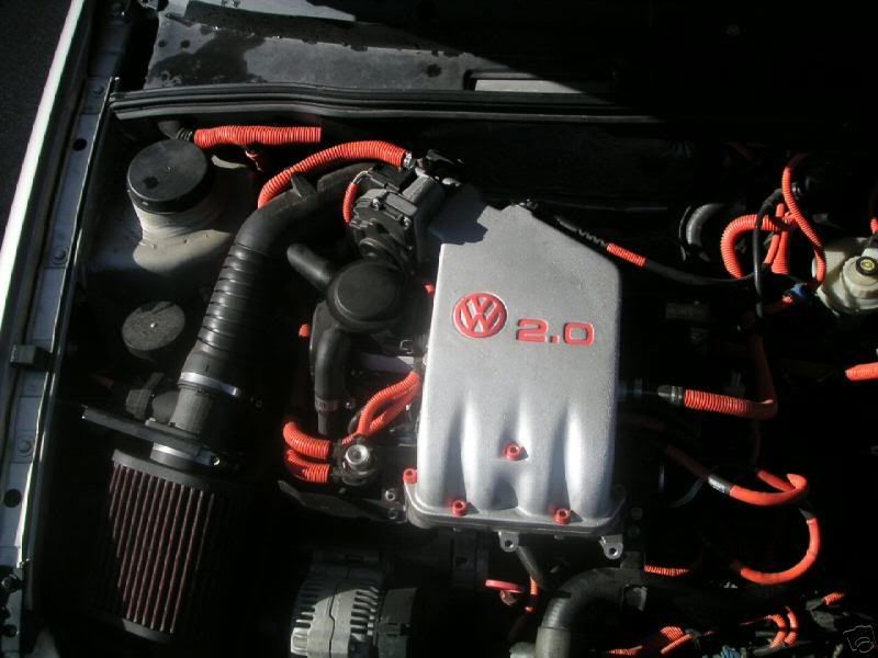

    Custom Painted Engine Intake with Custom Street Glow Orange Loom (LOOM IS EXTREMELY GAY AND COMING OFF ASAP)

    It doesn't look too bad. I'd just stick with your plans to remove the loom and interior bits, but I would leave the engine mods alone. For the shift knob and boot, you can get a Mk4 shift knob & boot to replace the Mk3 one. The Mk4 knob and boot look much better. As for the pedals, you should be able to get Audi TT styled pedals (the brushed metal look ones) that fit perfectly for around $90. I would paint the air ducts, repaint the side trim (it looks kinda funny in the pics), get a Euro VR6 front lip (like $100, can be found on just about any VW enthusiast site), and get a badgeless front grill. If you need to know something about the car, ask me. I have official VW shop manuals, a Bentley repair manual, and several other repair guides for the Mk3s.

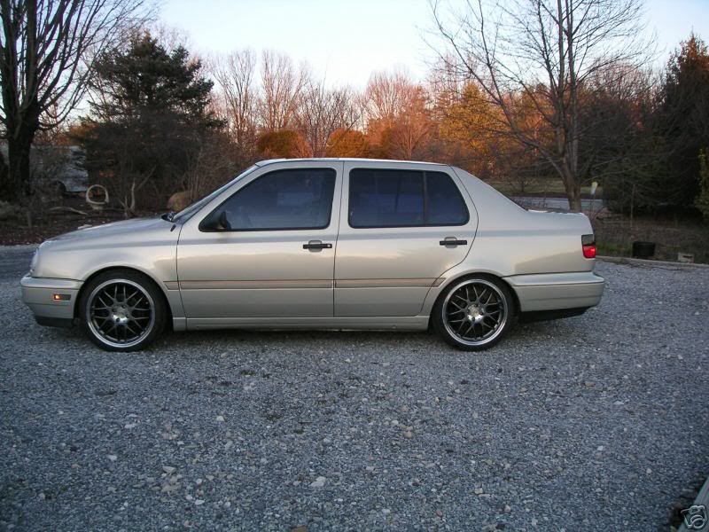

    lower the front more

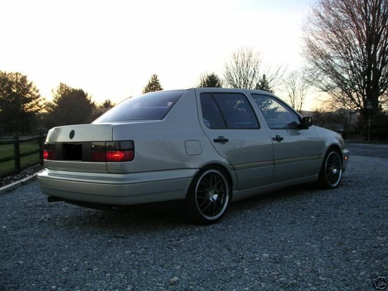

    First thing it looks like ya need to take care of is that reverse rake. Man it looks like you got a bunch of dead hookers in your trunk. Car does look very nice though Im not hatin.

    yeah, it looked to me like the suspension need a little revamping as well considering the ad just says sport springs 2 inch drop and no brand, probably some shitty stuff with a poor ride. I found a tokico strut and coil combo for around 400 bucks, is the tokico stuff for these ok for a DD. Take into account this will never be a high performance car, I have the 240 for that.

    If you want a good coilover setup for cheap, look up Patec Holeshot Series 4 Coilovers. You should be able to get them for around $700.

    If whoever did your wiring did your suspension... you probably have cut stock springs. Or even worse... those E-bay coilover sleeves that fit over the stock strut :puke: :laugh:.

    how would you know if the wiring was done poorly or are you just talking about in the poor taste in putting in bright orange wire loom?
    I dont think the wiring looks bad though its cleaner than my engine bay of my 8V
    Just the orange loom. It looks like the wiring is all right and they just put loom over it. You also mentioned the DIY wiring for the neons in one of your posts too it gave me the impression that they didn't do a good job w/ wiring them up.

    Information I got actually says "custom" wiring, you and I can take that as we want I suppose, It didn't really bother me because I'm pulling all the ricey gay lighting out as soon as I pull it in my garage as well as all that loom bullshit. I'll get it over to my shop and up on the lift and check the coils out too. From talking to the guy he didn't do any of the work himself, had some custom shop in his town do it, so who knows.

    Looking through your first post again, I see that your engine has those +4 platinum plugs. You might want to replace those with the OEM spec plugs. I know for a MkII 8v they are just Bosch single electrode coppers (supers), but for a MkIII they might be the dual electrode coppers. Go with the OEM spec plugs and you will be happy with it. I wouldn't use platinum at all unless thats what VW says to use.
    In the previous post where somebody was talking about coil pack... coilpack is a large coil with a wire going to each cylinder instead of a distributor. IDK if VW used coilpack ignition on the OBD 2 or not, but I do know the OBD-1 has a regular coil and distributor. The difference in engines between years is OBD-1 and OBD-2. The OBD-1 is the most desirable because it has a forged crankshaft, the OBD-2 has a cast crankshaft. The difference is in the engine management systems. OBD-2 enables you to hook the engine up to a code scanner.
    You might also consider swapping the cone filter for a stock airbox, the VW airboxes really aren't restrictive, and they keep the motor from sucking up hot air from the engine bay.
