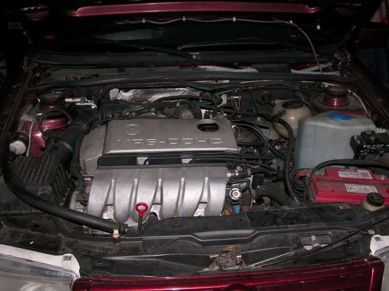

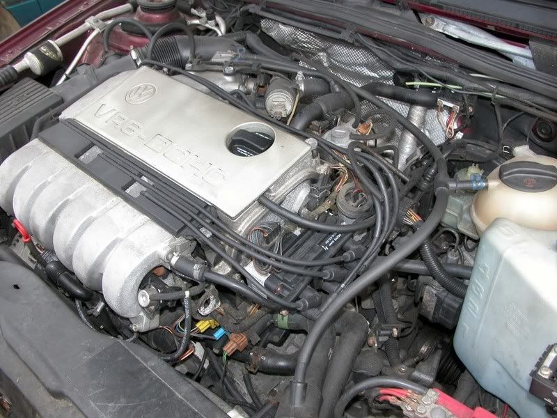

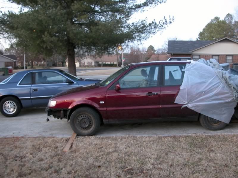

    Well me and a friend of mine drove 3 and half hours to and from Huntsville AL to pick the car up.
    The car looked really nice but we didnt end up getting it started but it did turn over. We didnt really try too hard since it was raining freakin cats and dogs on us all day. Things are coming together quickly.
    Lee
    2005 C55 AMG
    durtydubs
    Say What??? thegreatfnr's Avatar
    460
    **** UPDATE ****
    We got it running today. It was a little ghetto rigged but it worked to just make sure it ran good. The motor sounded great especially since it was basically straight piped withthe muffler falling off.
    It kinda chattered a little but i think all I need to do is change the Timing Chains and it will solve that issue. Hopefully Ill be dropping off the donor to the shop tomorrow or thursday then my car is suppose to go in monday for the actual swap.

    Thanks Im just hoping the motor runs as good as it looks. The current owner hasnt seen it run yet. He bought it from a JY and the fuel line from the tank was melted or something so he hasnt tried starting it yet. So im gonna ride out there and make sure it runs solid first but it should.
    He said it had paperwork of some work done on it back in august so I assume it ran then and that the only reason it was totalled was for the fire.

    lol the donor car is like the definition of heaven and hell... lol.. nice though, the jetta should be kickin now...
