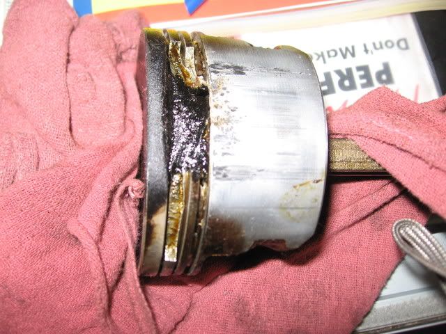

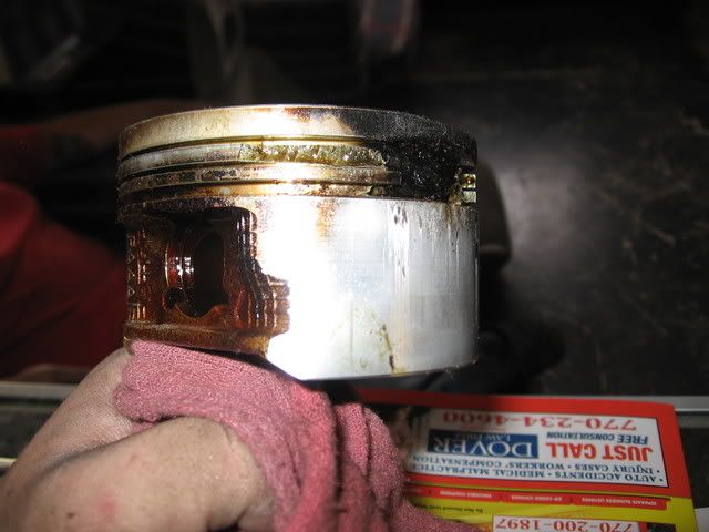

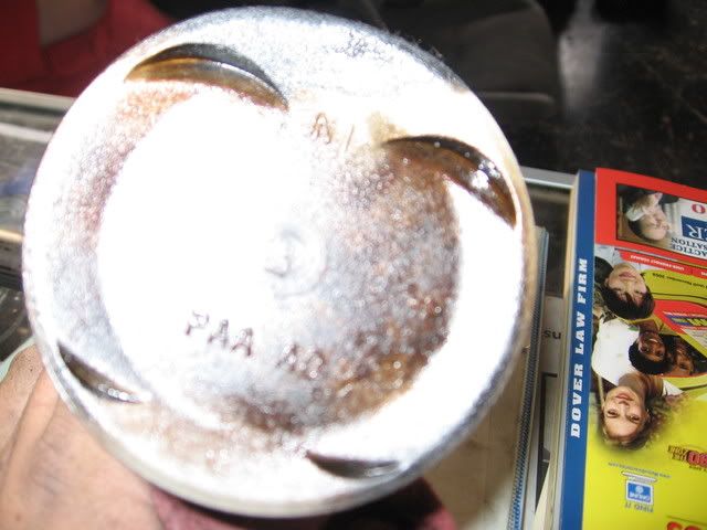

    Just pulled the motor apart, everything looked great for 155k miles. bearings goor, clean pistons etc... but apparently it didn't love making 265 to the wheel
    enjoy

    Its my fault it happened, my injector wiring shorted on that cyl, guess I didnt have enough heat shrink on it and the wires touched causing the injector to stop working. she woulda made it if that didnt happen.......
    The EMPIRE
    17,271
    joe 6 pack wiring ftmfl!!
