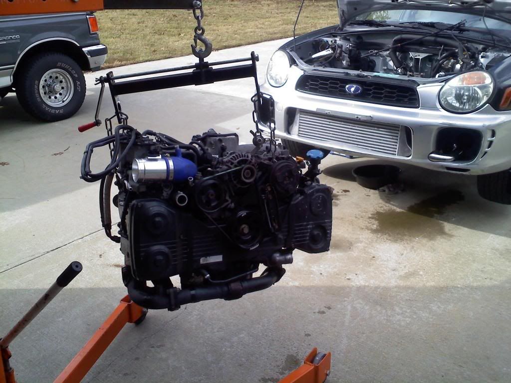

Well originally Scott's Machine in Fayeteville overhauled the cylinder heads and did a shitty job. I spent MONTHS trying to track down a compressor surge issue that I found out just a couple weeks ago was being caused by leaky valve seats. So the motor removal was coming but not planning on it being this soon...
Bought a blow of valve (aka Ricer Valve) from LB last week and dad wanted to check it out for shits and giggles. He installed it and made a few pulls and then I came home from work and made one pull and knew right away something was off. Apparently the factory recirc valve (which is claimed "good" till 24psi) was leaking by 3-4psi by my calculations (can't determine exactly sice the factory MAP sensor only reads to 22.76psi) but I suspect it seen 26-27psi before I turned it back down to 22psi. I don't think the headgaskets/head bolts liked that too much.
We didn't suspect anything and went to the track the next night. While fighting excessive wheelspin at the lights I managed a few 12.35 passes at 113-114mph. After my last 12.3 pass Dad noticed coolant bubbling out of the overflow tank. We drove it home and checked compression the next day. Two cylinders are below normal but right at the "service limit" while the over two are WELL below the "service limit." :no:
So out it came. Dad's frustrated and doesn't wanna spend any money, but I'm trying to push him to go balls to the wall in one last attempt to get it right (his car's always been plauged with bad luck). If he listens, I see high 11's in the Queer Kar's future at 117-118mph.... :boobies:
