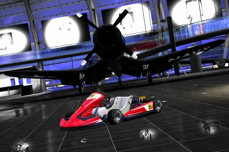

F4u corsair in first pic

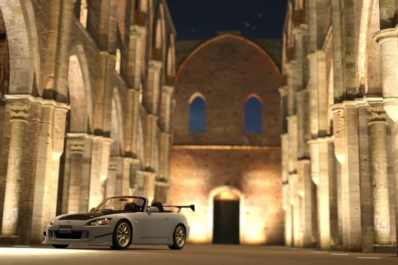

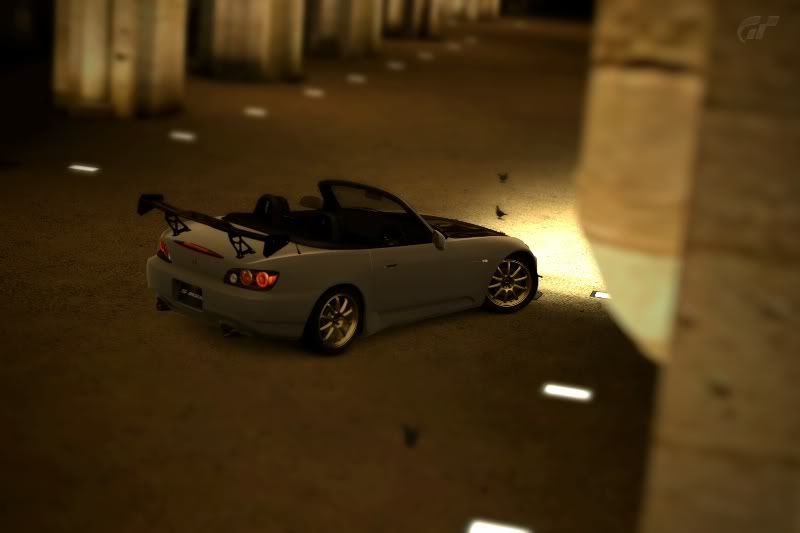

Tommy, your S2K looks primered?!
