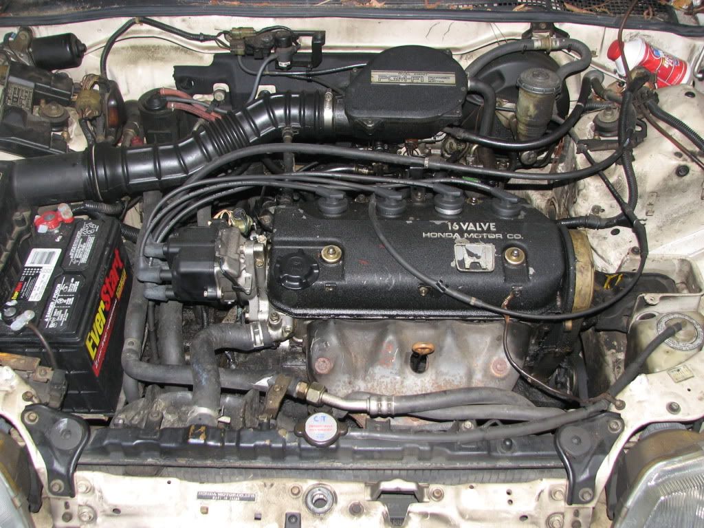

    well, apparently mine is dual point.
    but speed is not the concern here, i have the evo, its mostly the price.
    but yeah the 1.5 sounds like a better deal.
