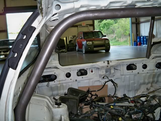

Whats that peaking in the first pics?? Thats right, started on the cage. I just have the main hoop done right now. Pretty happy with it, could be better though ((Im anal)).
The reason I put it on top of the hump is because Im 6'5". If I put it on the floor there would be no room for a cage.
It will technically be a 6 point cage. The "door" bars will end at the front of the seats. Im basically running it cause the cage is on top of the hump, just a little something extra to strengthen things.
I still have to make the floor plates. This will move the cage about 3/4" up closer to the roof. I will have to redo the brake lines, fuel lines, and fuel filler tube. I was kinda plannin on redoing them anyways.

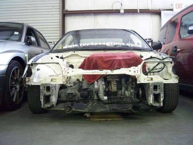

BTW another update!! The radiator and wiring harness have been ordered. Should be here within a couple days. I got a Scirocco style radiator that should tuck perfectly into the radiator support. Its shorter and wider than stock and will give me plenty more room for the turbo. I have a Koyo half radiator for an EG at the shop but I didnt like the way it fit. Just didnt look right.

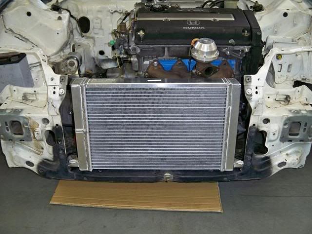

Its an AFCO Scirocco style radiator. Its a full size so no worries about overheating on the road course. Heres a link to the eBay page. I made a cardboard copy and its gonna fit like.... well, Ill keep this thread PG-13.Originally Posted by ZenMotors
Updates updates!!

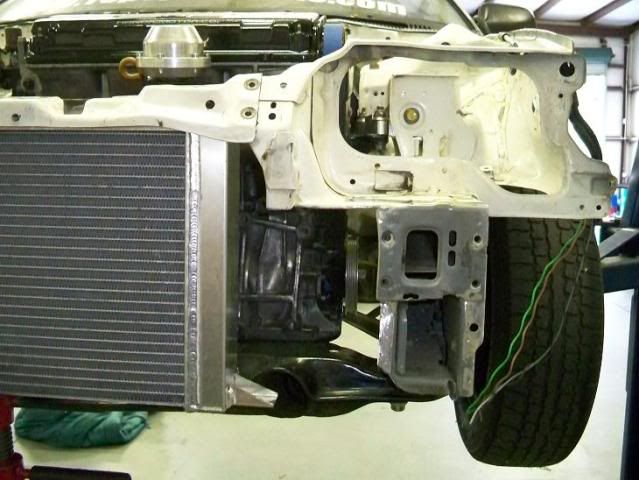

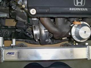

Got my radiator in today, super excited. Its actually smaller than I expected and that a good thing. It gives me more room for the intercooler. I ran into a couple snags though. I gotta flip the turbo around the other way for fan clearance. Also gotta move the radiator further forward for wastegate dump tube clearance. Its all good though. I didnt wanna move the intercooler too far out but cooling is more important than being stealth. The second pic is before I oticed the dump tube, itll be about 1/2 inch further forward. I can almost put the t-bar back in but with the radiator farther forward I cant use it anyways, to bad it was a clean t-bar.

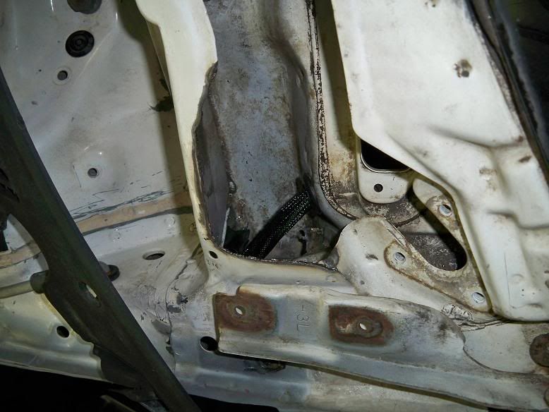

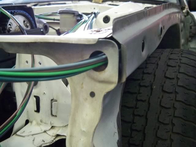

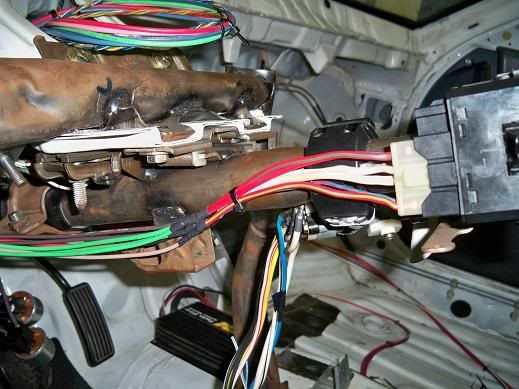

I started on the harness. Forgot to take a pic of the fuse box and all. This thing is huge. The headlight harness ALONE is 17 ft long!! I havent unraveled the rear harness yet but Im sure its just as long if not longer. I had to pull a few wires out that arent getting used and reroute some that are in the wrong spot. Coming along well I guess. This is the only real pic I got. The harness will come out of the cowl area into the frame rail and come out the end. It will split to go to one headlight and then to the other side. Should be well tucked style

I worked on the harness some more today. I have the whole front harness loomed and ran through the frame rail. I had to reroute it from whats in the pic above but its still hidden pretty well. Youll have to be looking for the harness to find it. The harness I got doesnt have any grounds in it, I have to make them all myself. Time for another trip to Fry's!! Gotta get more loom, a spool of black wire, and some good ring terminals.

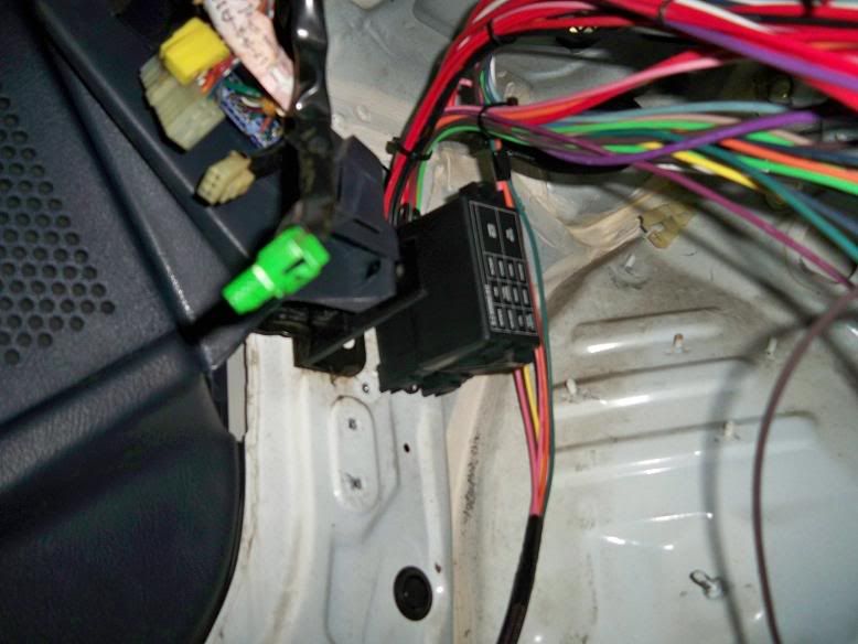

First is the fuse box location. Its attached to the lower A-pillar right behind the dash.

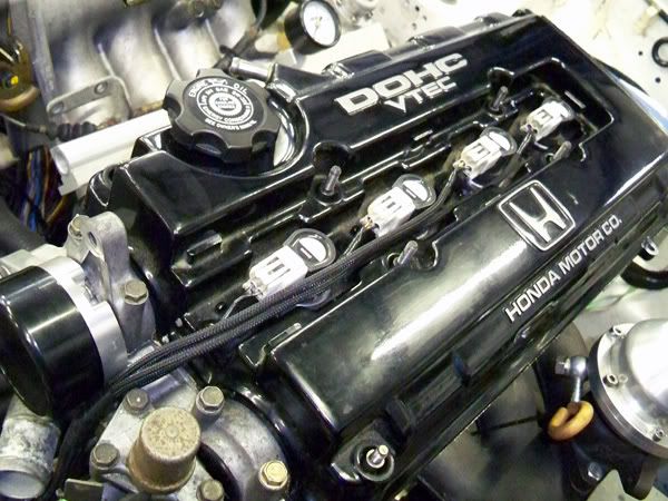

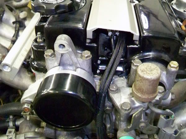

I got the AEM EPM mounted and all wired up. Then I got the harness from the AEM Twin-Fire Ignition Box to the coil packs all wired up. Everything is still nice and loomed. Only thing I can think of that left to wire up in the engine bay is the electric boost solenoid. Then its back to the interior or finish the exterior lights.
Oh yeah, you can see my new pretty valve cover...

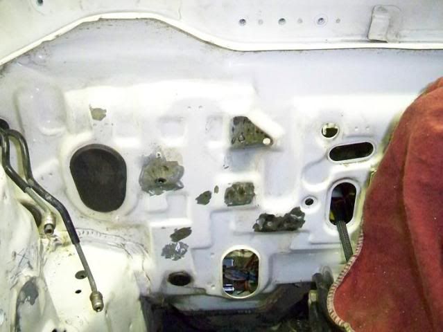

I also hacked the shit out of the front end. Im going to do custom radiator/intercooler mounts that bolt to the factory bumper beam location. It was the best way to do it. Im doing a double backdoor IC setup so this stuff would have to be cut out anyways. Just will make it easier for me in the future when I wrap things up. I also worked on shaving the firewall. Got the evap canister and fuel filter brackets removed.

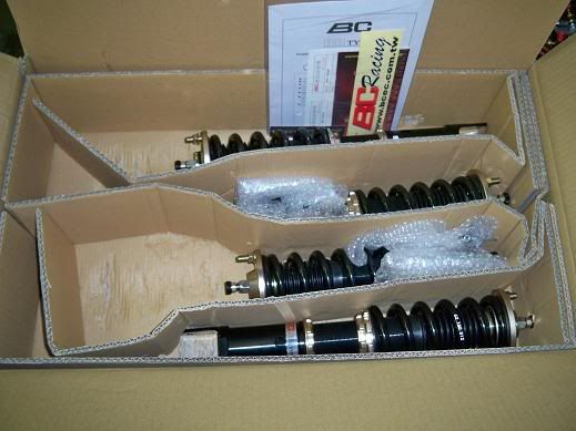

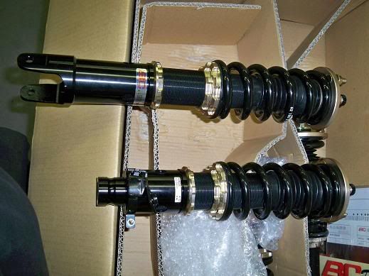

I also got my BC Racing BR Type Coilovers in the other day. Happy Days!!! I got them ordered with custom spring rates. 8k front 12k rears. Im also going to order a set of 10k just in case the fronts are too soft or the rears are too stiff. They have 32 way dampening with seperate ride height and preload adjustments. I think I am more eager to feel the suspension than the power of the engine when Im done.
