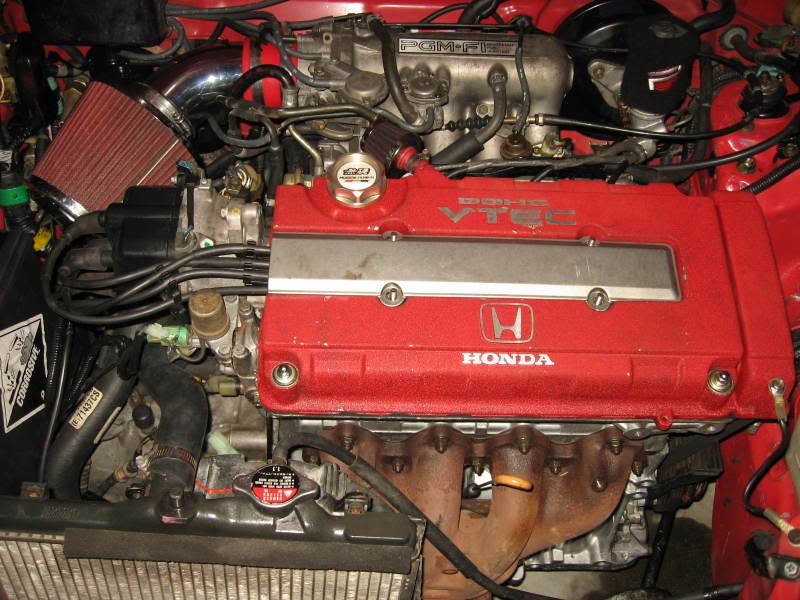

    recently finished up my swap and decided to make a little thread...is nothing too special just a stock ls/vtec b16 head and tranny, my original plan was to go with an ls but i started looking at how slow my car was gonan be so decided to go VTEC...this was my first swap in any car and my first motor build...did it all by myself.

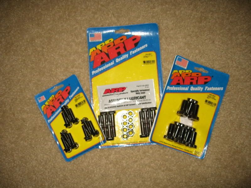

    arp head studs, rod bolts, main studs

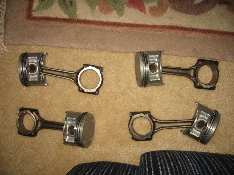

    stock ls rods. stock ls pistons

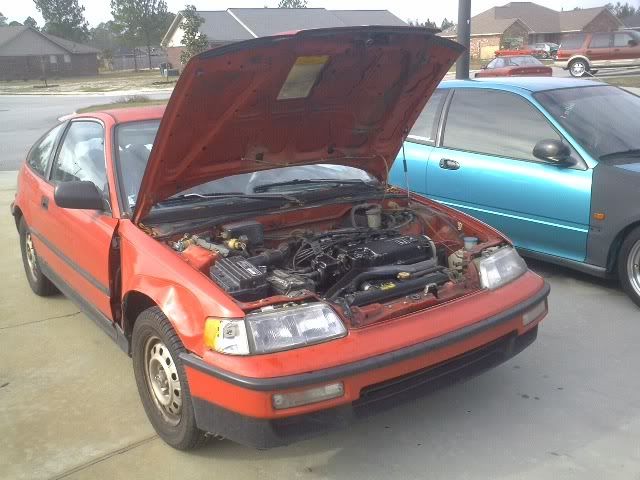

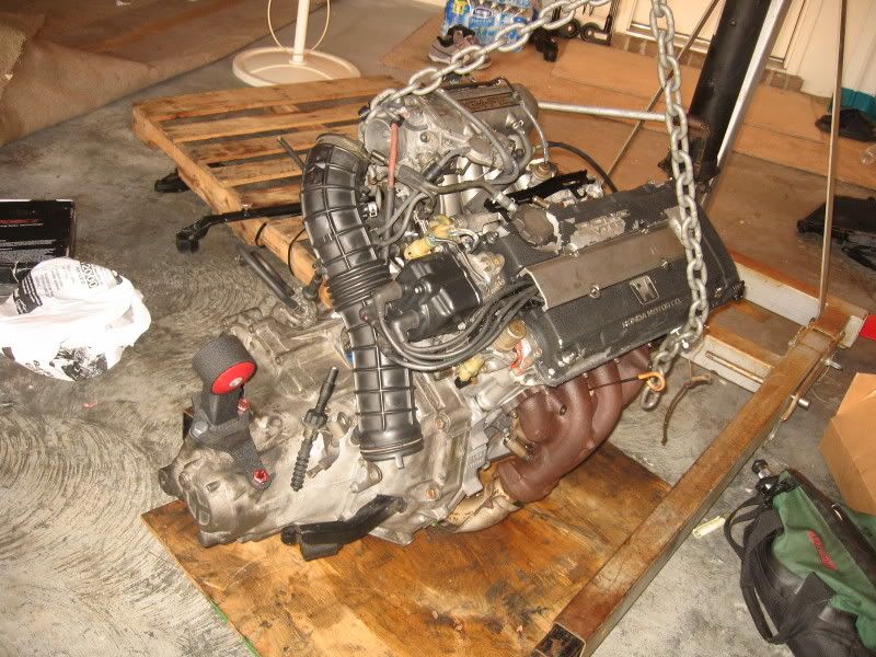

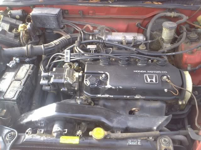

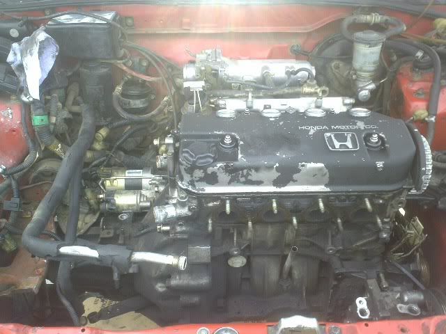

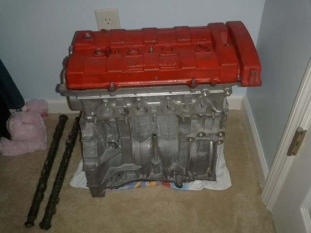

    here is wat i started with
    my ls motor i bought

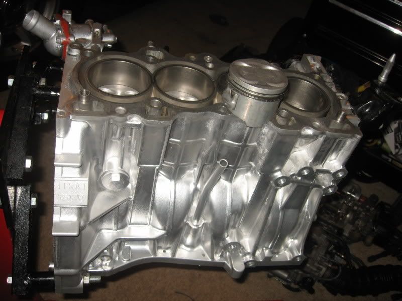

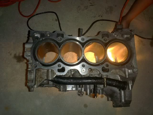

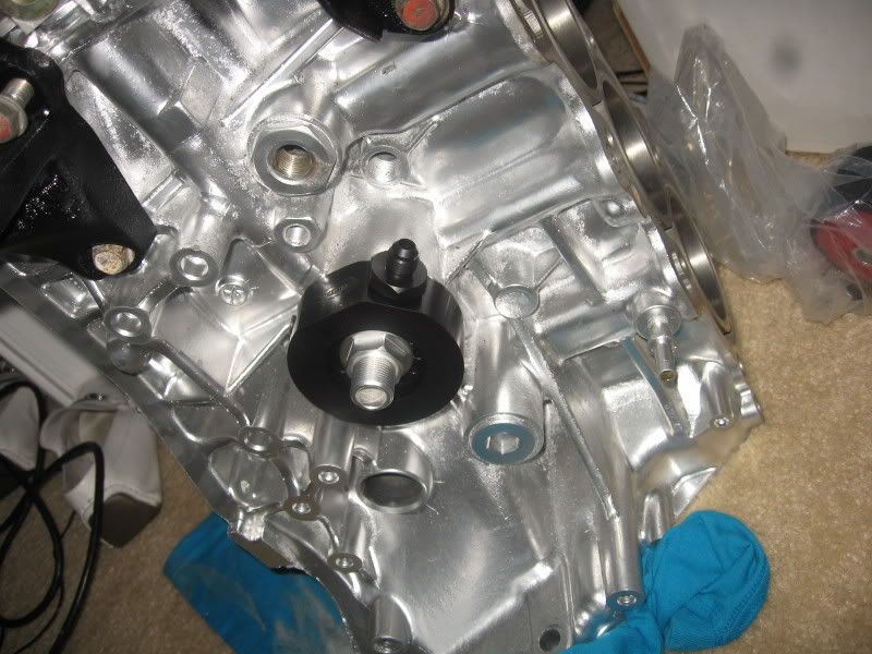

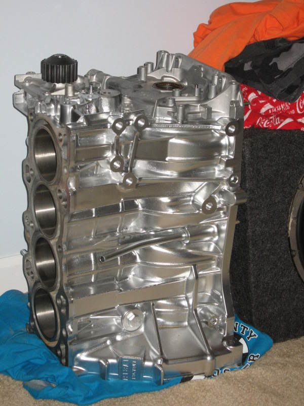

    fresh hone.

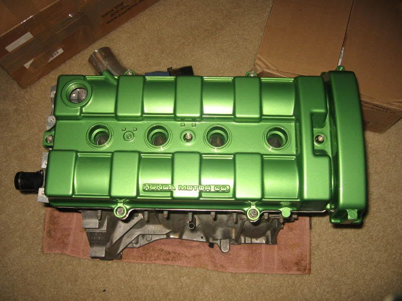

    had to paint my valve cover lol..its for sale if anyone running ls's.

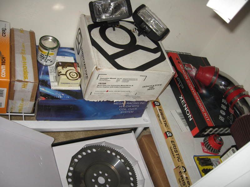

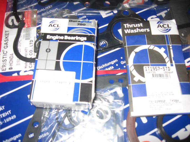

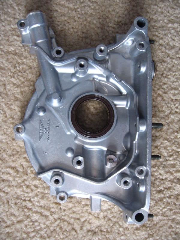

    couple of parts i got.

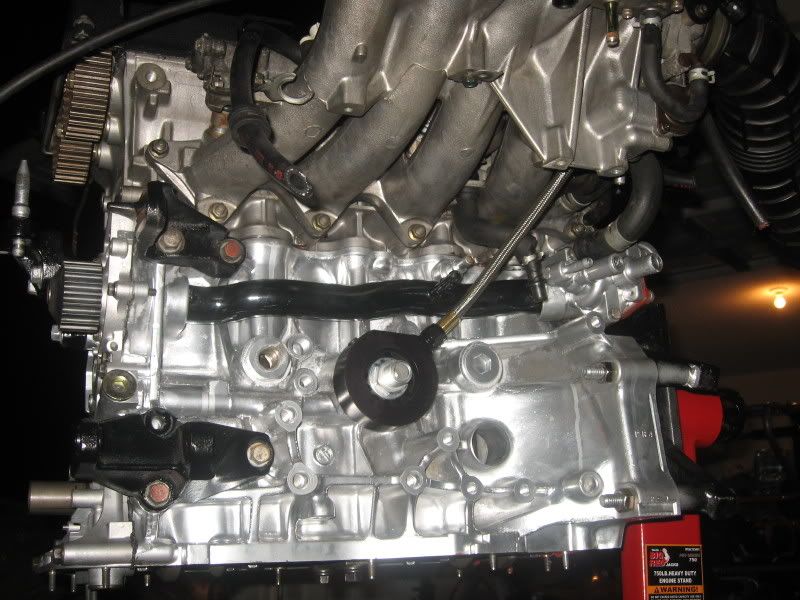

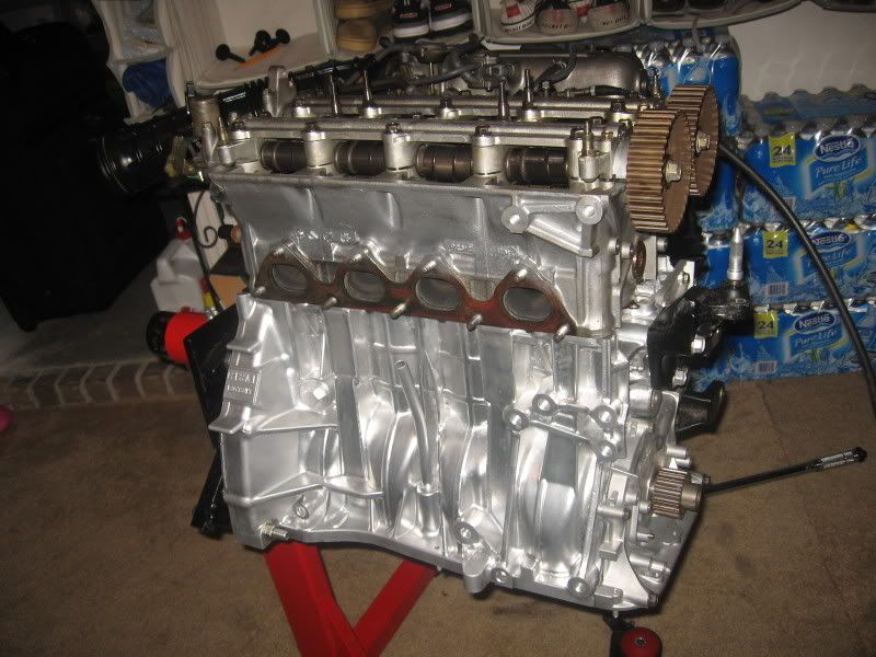

    saved up money and got all my parts for the ls...said fuk it and got me a b16 head and tranny...started the build fo real this time.

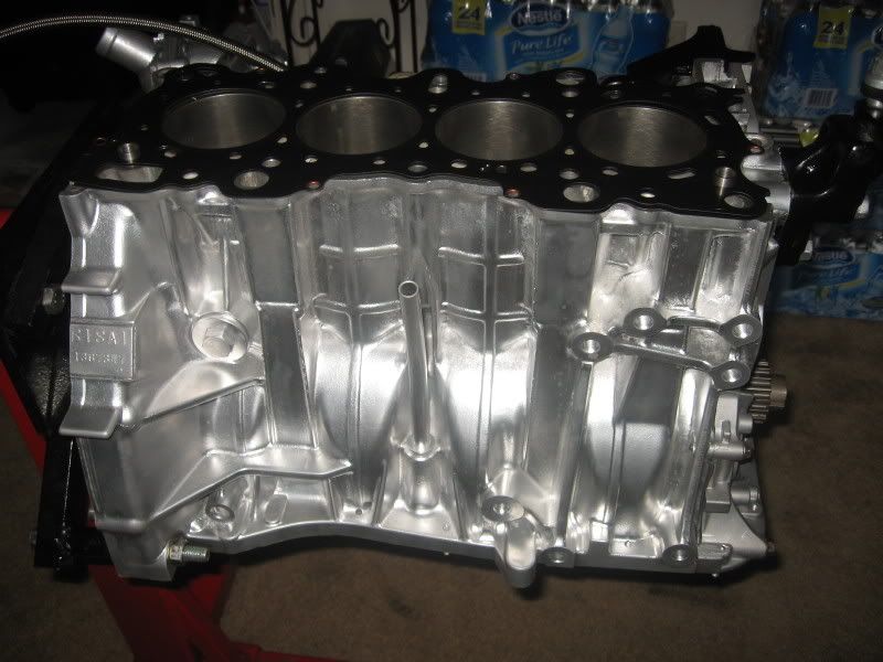

    dropping pistons in
    golden eagle adapter plate (sandwich plate) installed

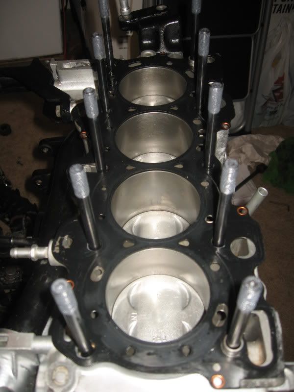

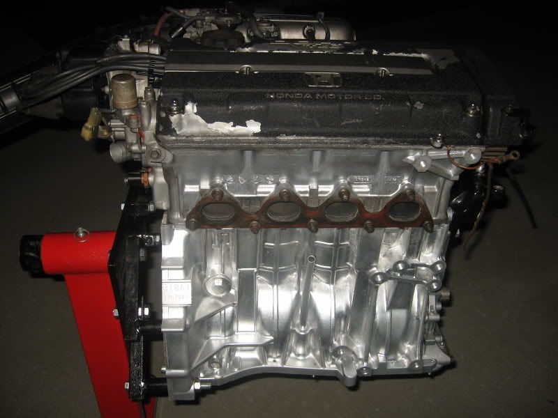

    head gasket and vtec dowels.

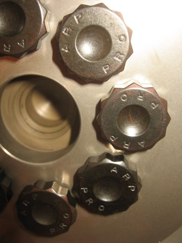

    arp head studs
    b16 head

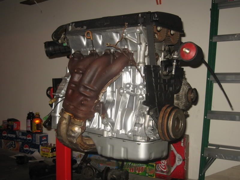

    timing belt, crank pulley, header and oil pan.

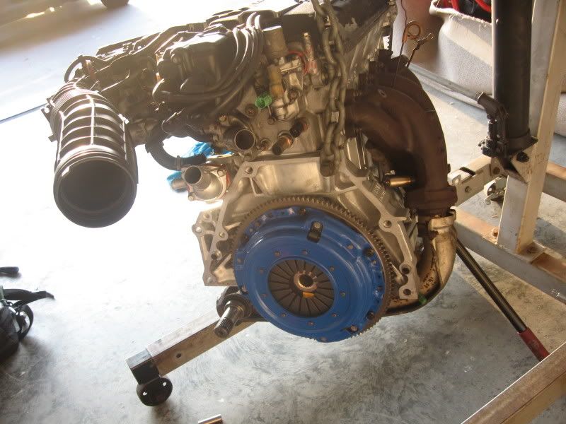

    flywheel
    clutch

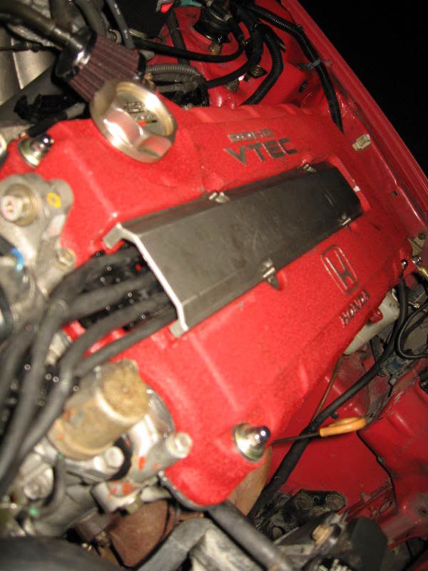

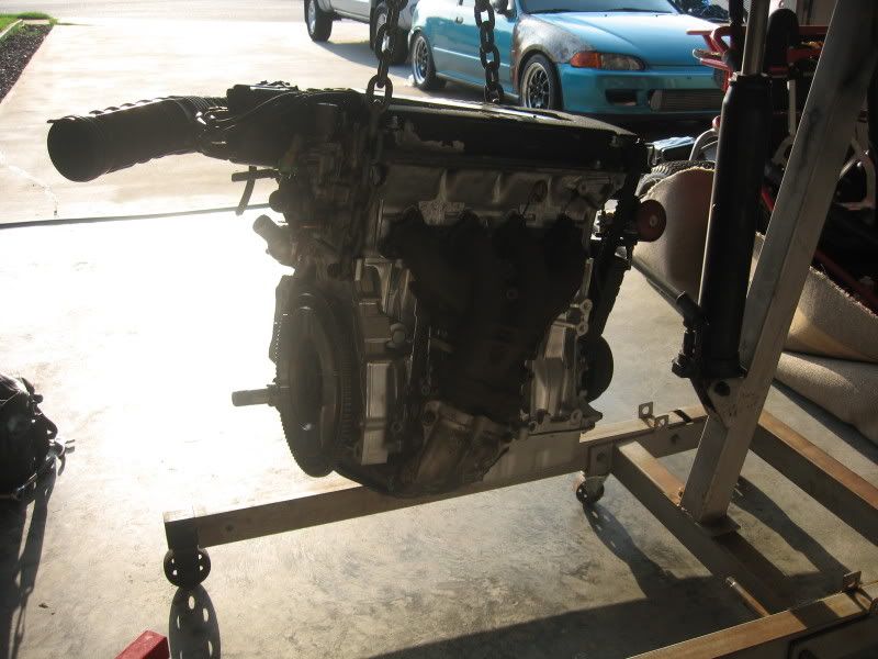

    tranny and mounts...shits ready!
    car just waiting
    play time.

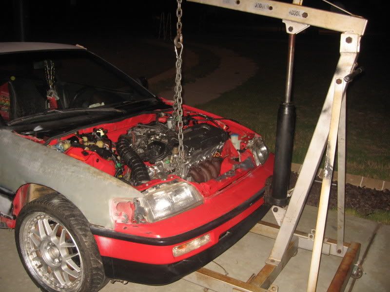

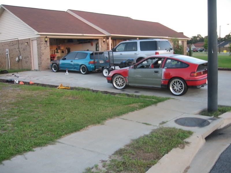

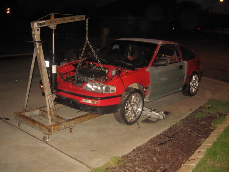

    it was a bitch, i fucking hate the rear mount bracket...but dont ever drop a b series into a crx by yourself at 9 o clock at night, your neighbors will look at you really weird and you want to throw shit at everyone thats drives by.

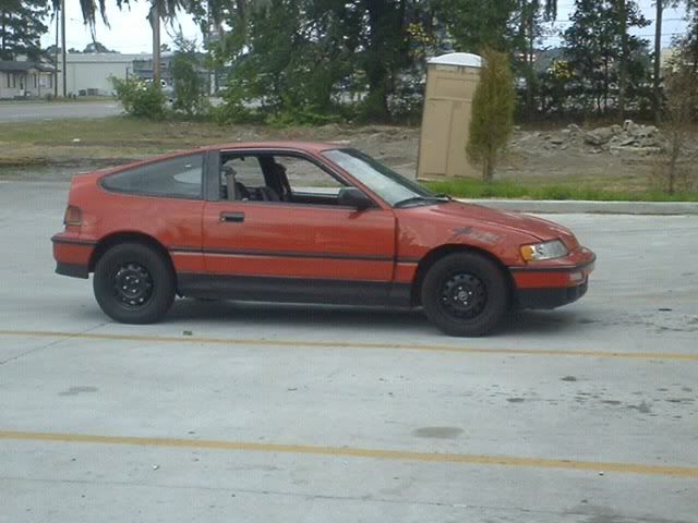

    kind of wat it looks like now.
    crx had some 17" racing harts i took off from my blue ef hatch before i junked it...their too big so i traded them for some si wheels just a couple of days ago.
