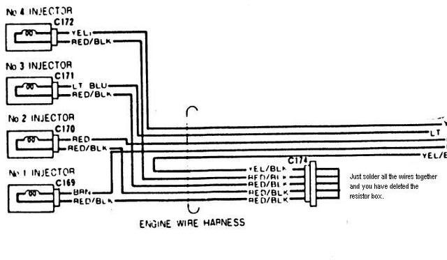

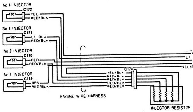

    Well I picked up some obd1 injectors for my car,my friend stated that I would need to do some wiring .Well I really dont have too much info except a few things found on honda-tech.I was wondering has anyone did this before.Some how I gotta get rid of the resistor box by soldering all the injectors together.Something about red/black wires with yellow and black wire.Someone let me know if you have did this PLZ.I dont wanna end up messing somthing up more than it already is.

    Taken from Boomslang:
    How to remove a resistor box from your MPFI vehicle
    • Unclip the resistor box connector.
    • Unbolt and remove the resistor box from your vehicle.
    • Cut the resistor box connector off of the engine harness.
    • Splice together ALL the cut wires that were going into the
    connector. We recommend soldering the wires together. Use
    electrical tape or heat-shrink tubing to insulate the connection.
    From locashracing:
    Injector Resistor Box Info
    If you are using OBD1 fuel injectors, remove the injector resistor box and connect all five wires (that were originally connected to the resistor box) together.

    Obd0 wiring
    Obd1 wiring
    I was just wondering does anyone have expirence with it,because I still have a few questions.

    The best thing to do is pickup another resistor box (or just the connector) and solder all the wires together. That way if you ever go back to obd0 injectors (or even dsm) all you gotta do is re plug-in your resistor box.

    The injectors I have dont require resistor box anymore.They are from a integra,and I want the lil thing I dont know the name of it but you can remove it.Its in obd1 cars.
