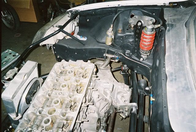

    okay so after carefully studying this pic i have decided that it's possible, this set-up has been ran on F1 formula cars for YEARS, the pic however is not a well engineered set-up, i plan on taking the basic design and taking it to the next level using better stronger materials that are lighter and probably less expensive, in the end the TOTAL cost for parts/labor should be no more than a good set of coilovers, im not talking about egay sleeves, im talking skunk 2 type c's, tein SS, and koni's but they will respond better,faster,and are more adaptable than any of the ones mentioned, i will be using my hatch as the test dummy to see what works best etc...you will be able to choose or make up your own spring rate according to the ride and performance you would like, the bodies i will be using are almost identical to the ones pictured with remote resi's dampening and rebound adjustable (ones shown in pics are NOT), and i will also need to know how much of a drop your wanting, keep in mind these will go up or down about an inch from where you tell me so there is some wiggle room if there needs to be. since nobody makes a kit i will be making them myself, if you decide you want a set thats great but i will not make several sets of them to sit on my shelf, i will however keep very detailed notes and measurements when making mine and will make them per order after a deposit has been made, again...these will handle better, be more responsive and tunable than a set of equally priced coilovers, thinking it's going to be around 1200 for EVERYTHING, you drop the car off, pick it up 1-2 days later and its done, this is only for the rear as of now, im working on engineering a kit for the front that allows both hood and motor clearance but were not going to get into that right now...whole other story... but on a serious note this is not something you see everyday and would surely turn some heads! i need a rough number of ppl that would be interested in this set-up so please add your name to the list accordingly. any and all questions can be posted in this thread as well. anyone i have done work for will vouch for me!

    That particular guy said he had about $250 in his setup using CBR600rr rear shocks. Honestly doesnt look that hard to do! It would definitely solve alot of problems with suspension travel etc that hondas have. (AKA FUCK extended tophats )

    Yeah, awesome idea for show and stuff, but as far as functionality, what's the benefit of this setup over just the economical way we've been doing it for so many years?

    Shock travel man. unless you have shortened struts on an EF, by the time they are lowered you have very little shock travel left.

    That's why stiffer springs and aftermarket struts are required. I ran Skunk2's with KYB AGX struts and was one of the best handlers (if not THE best with a better driver) up in the mountains. I RARELY touched the limits of the car. Not to rain on your parade, because I really do want to see the benefit of your setup, but I just would rather spend my 700$ on that setup, and spend the rest in a disc swap, SS lines, booster/MC and bushings as opposed to 1200 to change the geometry of a suspension setup in one of these cars.
    Respectfully, please slap me in the face if I'm not seeing something that makes it so much better. Again, not looking to rain on your parade, just debating.

    You can't compare your BASIC street setup to one that would see huge benefits on a racetrack. Mtns and an actual race track are totally different.(BTW skunk2 and AGXs is NOT one of the best setups) While this cantilever setup would cost more than a conventional coil over setup, it does have its advantages. However for price factor most people would never see the advantages this setup would yield in just a normal street car.
    Benifets that I see
    1. The ability to run a much more adjustable shock, and mounting point. Aftermarket motorcycle shocks have a much higher range of adjustments, Including high speed compression, low speed compression, rebound, preload, and ride height adj. Not to mention adjusting the pivot point, where you can adjust the ratio to make for different wheel travel to actually shock travel, making the shocks much more effective.(different spring rates would be needed)Not to mention these shock are rebuildable are able to be revalved.(PS to do this right run aftermarket motorcycle shocks so you can have them revalved, since the valving for motorcycles and cars would be quite different. Stock shocks only offer a small amount.)
    2. Ease of adjustments. Don't bother tearing your whole car apart to swap out springs or adjust you shocks. Everything is located inboard and out of the weather, allowing parts to last longer.
    3.Weight placement. Center weight is better, and a small amount of less unsprung weight.
    4. Wheel clearance. Not sure how much this effects EF, but some cars wheel widths are affected by how close the wheel comes to the shocks/springs. This would allow for one to run much wider wheels without hitting vital suspension parts.
    Im sure there are other benefits as well, and i'll add them when I think of them or others can chime in as well. Money aside this setup is far better than the conventional setup.
