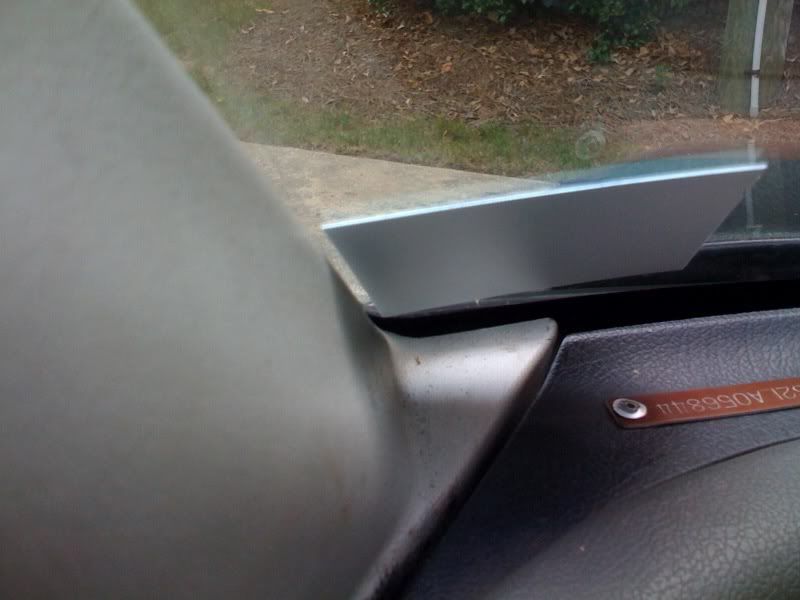

    i need the cover that goes under the steering wheel : (
    heres the small gap on each side you really can barely tell and im going to put some foam tape there just because im picky,but it's really not needed

    Not bad I was just going to get the part that goes around the cluster.
