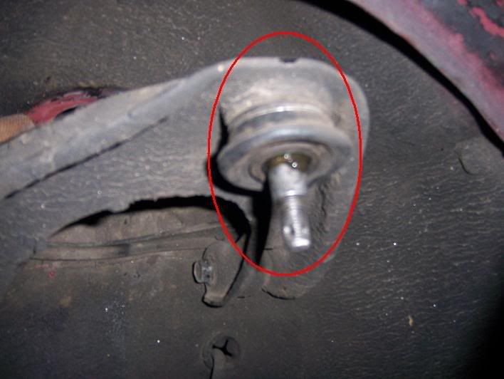

    I'm trying to do my front camber kit and its giving me hell. I tried to find how to do's on honda-tech.com but I just cant find one with pic's and enough info. I cant get the bolts off the upper arm control , but then again I dont know how to pop that thing out off it either (circled red) to replace it with the camber kit i got.
    here r some pic's of where I got 2 and where i stoped lol

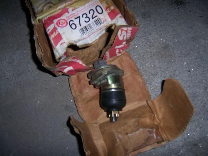

    here is the pic from the front camber kit

    those are sliding ball joints, BOOOOOO
    Sometime you have to take the whole thing off an use a press to press the old ball joint out.
    Should have gotten the SKunk2 Upper A Arms, they come preassembled

    it's pressed in, you can go rent a " ball joint tool " from autozone or advanced auto, you will need it to get the new one in as well, i highly recommend taking the control arm completely out of the car and setting on a bench for this

    I knew this would be hell loll... but ill see what I can do on the weekend.

    Are those the up to 1.5 degree kits, or the up to 3 degree kits?

    Those are the 1.5 to 3.0 joints, they were mine before I sold them to dare. Funny how parts get around, EFs are whores.
