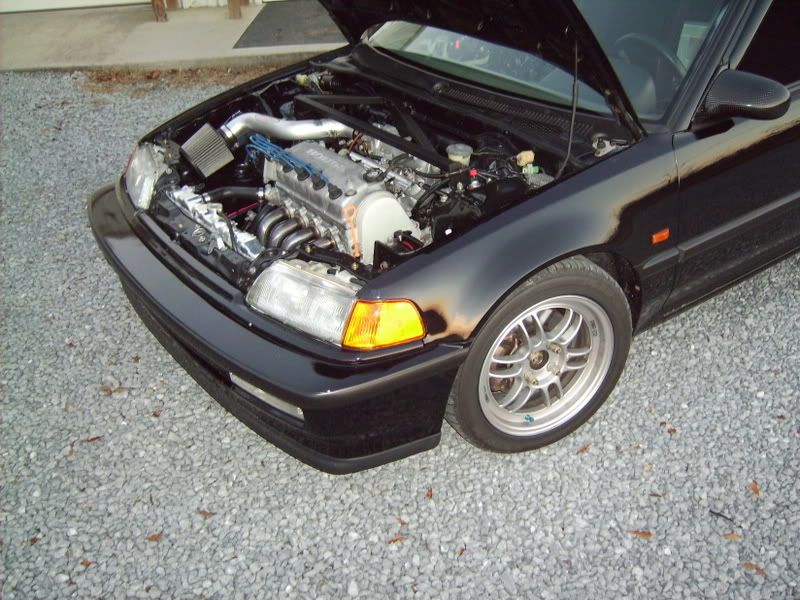

    Default NEW GA EF did it all myself
    came from this
    to this
    to this
    to this

    o its done i just couldnt figure out how to get the pics up and kept hittin enter
    got more pics too if anyone wants to see em

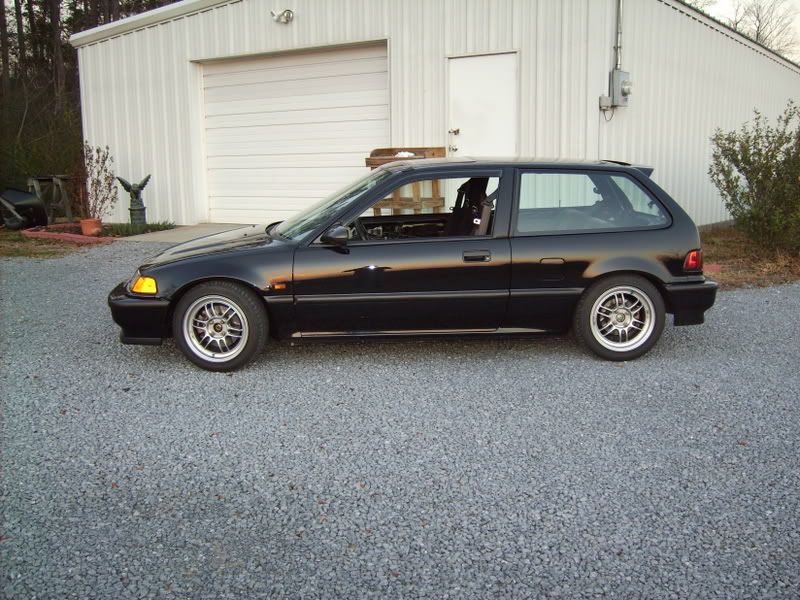

    those wheels in the last picture are SEX. i'm uber jealous bro!
    ur hatch looks great man.
    and if you ever wanna get rid of those wheels....then LMK, haha

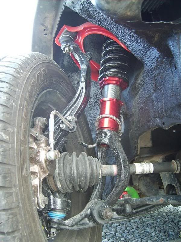

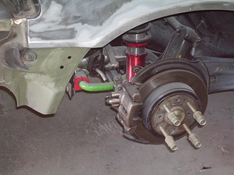

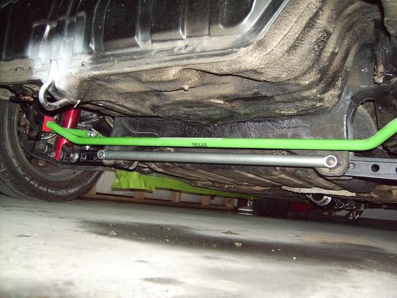

    CLEAN!! wut suspension set up is that?
    CBE ENGINEERING CBEeng.'s Avatar
    Resaca, GA
    381
    Quote Originally Posted by 4evasmashin
    thanks everyone

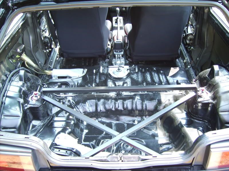

    form function type 1s, energy bushing kit, suspension techniques sway bars front and rear with custom rear endlinks, CBE engineeering fr. rear upper and rear lower strut bars, wicked tuning toe links, revo camber arms front and rear, DA knuckles, Russell stainless lines 93 ex coupe fronx brakes (hope to move to integra calipers soon) 4040 prop valve 91 ex sedan 15/16th master cylinder
    99 si rear trailing arms w/ DB and ES bushings BLOX LCA's skunk2 extunded studs and forged lugs new bearings, balljoints, tierod ends inner/outer and a master alignment. 15x7 41mm offset enkei RPf1 with fusion ZRi 195/50/zr15
    hope i didnt leave anything out

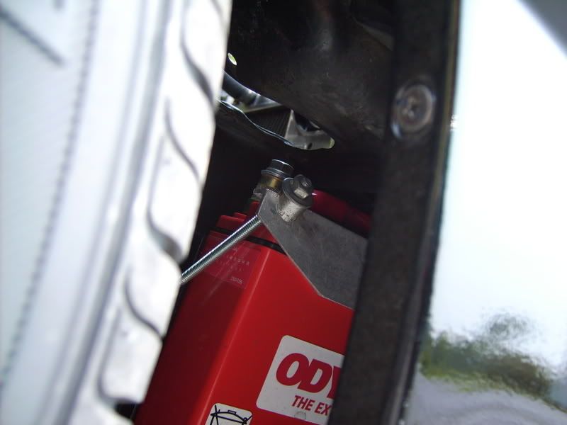

    i make these strut tower bars along with other thing primarily for road racing/time attack/ touge.

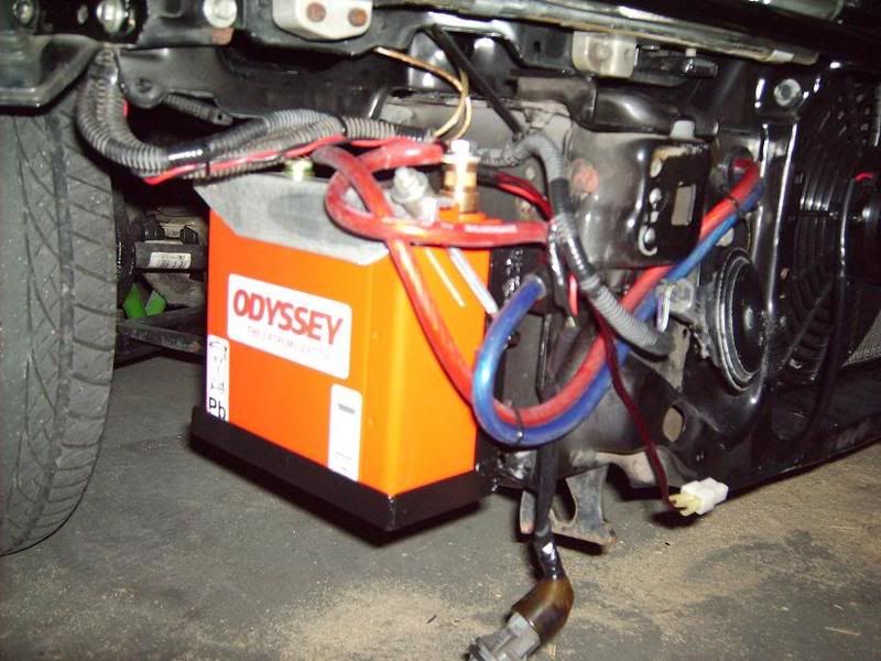

    also here is my battery tray
    i make the tray and the hold downs
    also make the lower rear bars

    Nice work man, how do you like that rear sway bar?
    Tuck'd & Swap'd Thundercat's Avatar
    Valdosta
    701
    that hatch is looking really good ...your parts look pretty sound too....lets us know how hold up..and keep the gold wheels
    zero
    339
    Quote Originally Posted by green91
    i love it i love the front too

    You are a shop?
    One thing though - you may want to reconsider the DA knuckles - iirc they are about 1" taller than EF knuckles..... and can affect your caster, camber, and of course travel of the upper A-arms to contact with the underside of the front shock towers.
    Quote Originally Posted by Tasuki_Civic
    i woke up to the feeling of someone cutting my clothes from my pants to my bra. all in one cut
    Resaca, GA
    381
    Quote Originally Posted by Black R
    I like it.
    You are a shop?
    I have a shop
    the uppers have never hit...probably cause of the 8k spring rate
    according to Ben Ogle's suspension write up they are a 1/4" taller and I have adjustable uppers and they dont affect caster
    http://www.ef-honda.com/ben/
    under tech...hybrid suspension
    Don't use DA integra UCA's. This is where a lot of people go wrong when using the DA knuckles. They use these UCA's and it gives them positive camber and less caster. Then they blame it on the knuckles. Waaaaaa...
    The DA knuckles (also with 10.3" brakes) on the other hand are plentiful, cheap and work great as well. They are, however, a bit heavier weighing in at 6lbs 7oz more per side than a full DX knuckle. Also, because they weren't made for any civic the geometry differences have been blown way out of proportion by message board folks and because of this, a lot of people are scared of the swap. The knuckles are ¼" taller than the civic knuckles but really, it is nothing. It raises the roll center ever so slightly and makes the camber curve a tiny bit more aggressive. So what? Who said the geometry was perfect to begin with? And caster is NOT affected by knuckles. It is determined by the ball joint locations on the control arms. So stop saying the knuckles themselves change/screw up caster! They don't and never will.

    yeah it's been a while since I compared - but I never looked at DA knuckles, only siR, ef ex sedan, and of course dc2.....
    Here's an old thread I did a write-up on:
    http://ef-honda.com/main/viewtopic.p...862&highlight=
