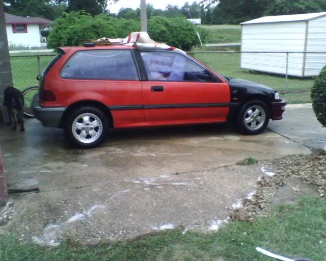

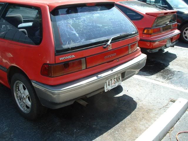

    Default Hatch Update

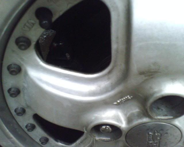

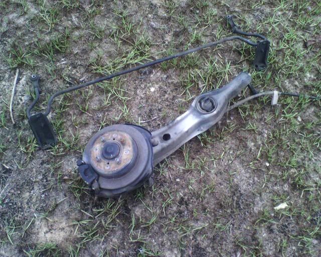

    Since this was a long weekend, I decided to work on the hatch.
    So my homie and I put in some wrench time and converted my hatch to rear disc. Since my new trailing arms had bad bushing, we install new energy suspension bushing. To install, we had to remove all the old rubber. So after an hour of playing with fire the trailing arms were free of rubber. The new bushing were easy to install! We installed them with a long as bolt (and nut), and two big ass washers. :boobies: Piece of cake! (I don't recommend ES trailing arm bushing, but since I'm building this car on a budget I decided to go cheap. I would install mugen or oem bushing in the CRX).
    results are here
    (sorry for the crappy pics, for got the cam so I used the cell)

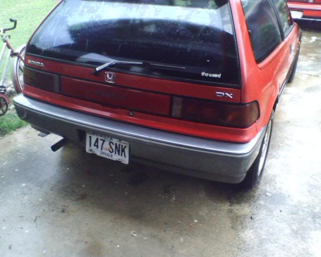

    Thanks to pull a part I have a clean set of taillights
    Before
    After
    After the install, I decided to give it quick wash
    To keep nature from taken over
    Here how the family do it.
