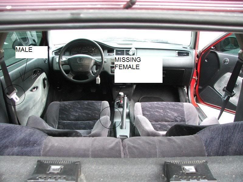

    alright guys, i'm stuck in a pickle here and i need yall's help...
    My Si seats = shit and really need to be upgraded. I've found an insane deal on sum black gsr seats, and i realy want them. only problem is, they dont come with the female end of the seat belt (i.e. that part that the actual seat belt itself goes into). I planned on swapping the seat pans and rails, because i figured this is a sure fire way to make the seats fit. From everythig that i've been told, the female end of the seat belt is part of the seat itself, not the rail or the pan. i haven't had a time to take a seat out to see for myself either. So my question is, after i swap the rails and the seat pan, and if the female end of the seat belt is connected to the seat itself, is there anyway i can somehow put it on the new seat?
    I just thought i'd ask because i noticed that sum EF's at the meet had integra seats and was wondering how they did the seat swap. I thought that different male end seat belts would only fit with their female counter part . this whole thing has got me confused, and i'm not sure what to do. It's such a great deal that i'd hate to let go.
    Here's what i mean if you dont understand my terminology
    dont laugh at my artwork . But in all seriousness, i need sum one to steer me in the right direction.

    .. I was too lazy to read your essay but I think I get what you're saying. Just do some customizing & mount the Female from your Si seats now, to the GSR seats so that you're MALE can snap in.
    That's how my seats are & I have aftermarket seats.

    i mean, fitting the seats into the car is no problem i hope.
    my problem is that the seats i'm getting have no female end for the seat belt.

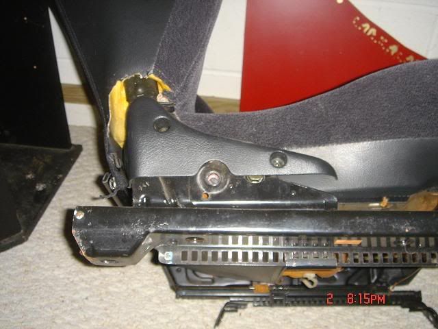

    okay well i've got sum good pics of the seat.
    the guy said that the female end of the seat belt is held onto the seat by a few 14mm bolts, so i'm hoping that's how the EF seats are too...if thats how they go on than great, if not the i'm SOL.
    anyone know for sure how the female end of the EF seat is held on?

    I didn't really look when I did my seat swap. But, I'd be willing to bet that if te whole EF rail from the inboard side will bolt to the GSR pan, your problem will be solved.

    yea, i'm sure that is the case, but i still need a female end of the seat belt, lol. ik if i swap the rails/pans then the seats will fit. The female end of the seat belt on the EF seat is on the seat itself, not on the rail or the pan... so i'm guessing i can just take it off of the EF seat and put it on the integra seat...

    Anyway, the part you'll have to swap from your EF seat to the GSR seat is that inboard hinge part. It unbolts from the seat back and side of the seat pan. You'll have to undo some of the upholstery from the seat back to get at the two, or maybe three, bolts that go up the side of the seat back.

    i think i'm just going to take a look @ my seats today, look at the female end of the seat belt and look @ the holes in it and see if they look the same as the GSR seats

    yea, i went ahead and picked up the gsr seats today. They look amazing. Got em for $100 too. I think thats a deal, considering it's hard to find a nice set of black gsr seats, it was for me anyways.
    But yea, the buckle is mounted to the seat on the teg seat too, so it looks like that problem is solved, but now i need to know how they're going to fit.
    Just swap out the seat pan and rails and they should fit, correct?

    Anyway, i took out a seat tonight to get a little insight into how much work this project was going to be. I didn't swap the pan or the rails, just stuck the GSR seats in the car and 3 out of 4 bolts bolted up. and then i just made the 4th hole fit. Not too much work at all.

    What I was referring to was the brackets on the sides of the seat. On the inboard side, The part that pivots is bolted to the side of the seat pan and to the side of the seat back. The bolts are hidden under a plastic cover for the pan bolts and under the upholstery for the seat back.
    But, if you got them to fit without having to take the seat apart, then that''l work too!

    yea, i got them to work, so w/e. they look good too. Oh yea, and the seat belt buckle just came off of my Si seats and bolted right onto the gsr seat. I forgot how much shit interchanges with hondas
