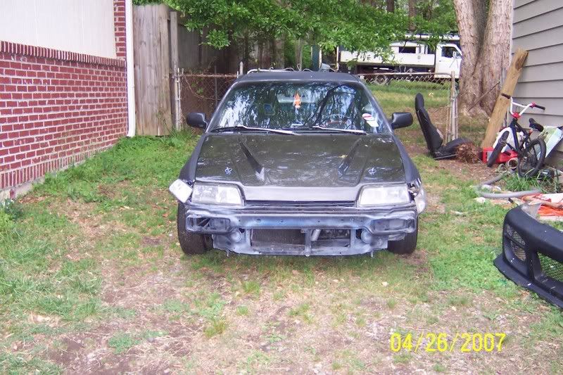

Here's what happened today. After looking up how the bulkhead would be replaced I decided it was something I could tackle myself. So I recruited the help of Darryl and we got started.
We started by stripping down the front end

We had initially planned to drill out all the spot welds, but that was painfully slow. So we adopted a more direct approach, a chisel and a hammer. :king: Here's Darryl breaking some welds:
http://pic50.picturetrail.com/VOL488.../249330069.jpg
Here's the car with the old bulkhead removed:
http://pic50.picturetrail.com/VOL488.../249330063.jpg
http://pic50.picturetrail.com/VOL488.../249330139.jpg
And the new one in place:
http://pic50.picturetrail.com/VOL488.../249330117.jpg
New headlights installed:
http://pic50.picturetrail.com/VOL488.../249330112.jpg
And hey, look at that! I just saved hundreds of dollars! :D

Jfro, that looks AWESOME, man. Did you have to weld the bulkhead on? I'm looking at how the bulkhead mates with that main bar...the ones that run down the side of the car where the fender mounts to (at the top of the fender)??
Looks good Jeff!!!
jeff you should post a before pic.
Thanks guys. We didn't weld the new bulkhead on... It's just bolted on and it's rock solid. In my opinion it doesn't need to be welded, it's absolutely not going anywhere. In hindsight though, we could have used 3M panel bond to bond it on.
It mounts at the top corners using the same bolt that holds the fenders on. (the forward-most bolt on the top)
OK, this is the reason the bulkhead was replaced:Quote:
Originally Posted by bigdare23
http://pic50.picturetrail.com/VOL488.../243535097.jpg
