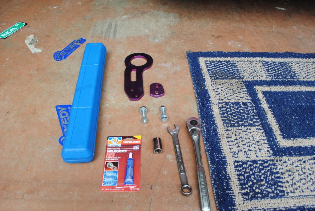

    tools needed:
    -18mm box wrench
    -18mm socket wrench
    -1/2 torque wrench ( you really dont need one i just like to use them, better safe them sorry )
    - lock tight.
    with my kit it came with:
    -1 rear tow hook
    -1 clamp
    -1 set of bolts with 4 washers

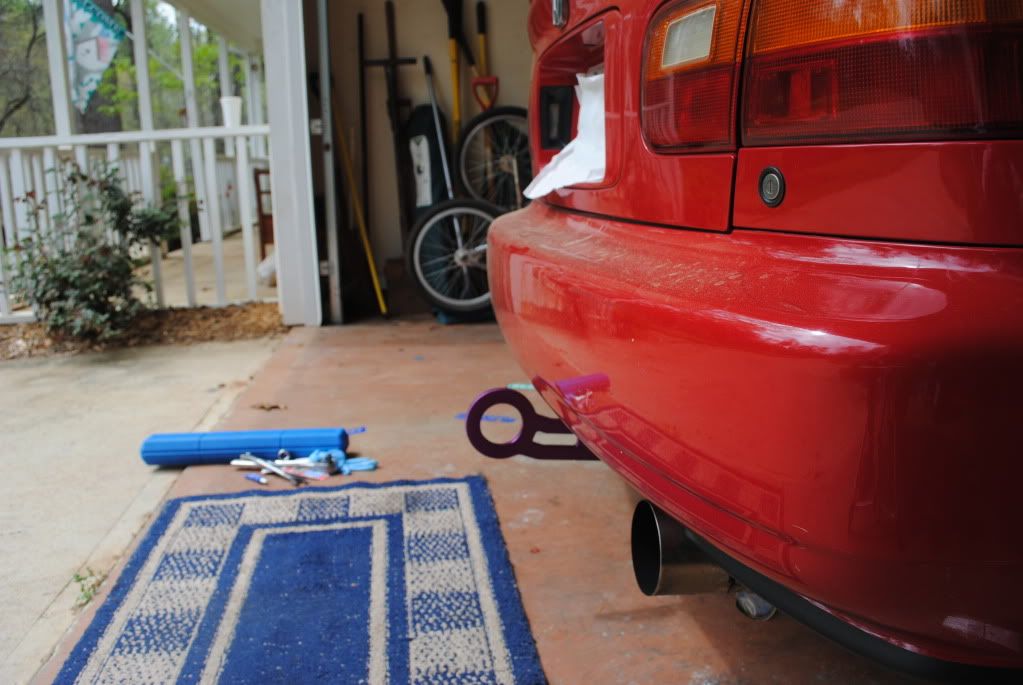

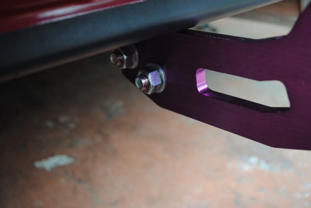

    step1:
    take you tow hook and clamp and bolt with washers that comes with kit.

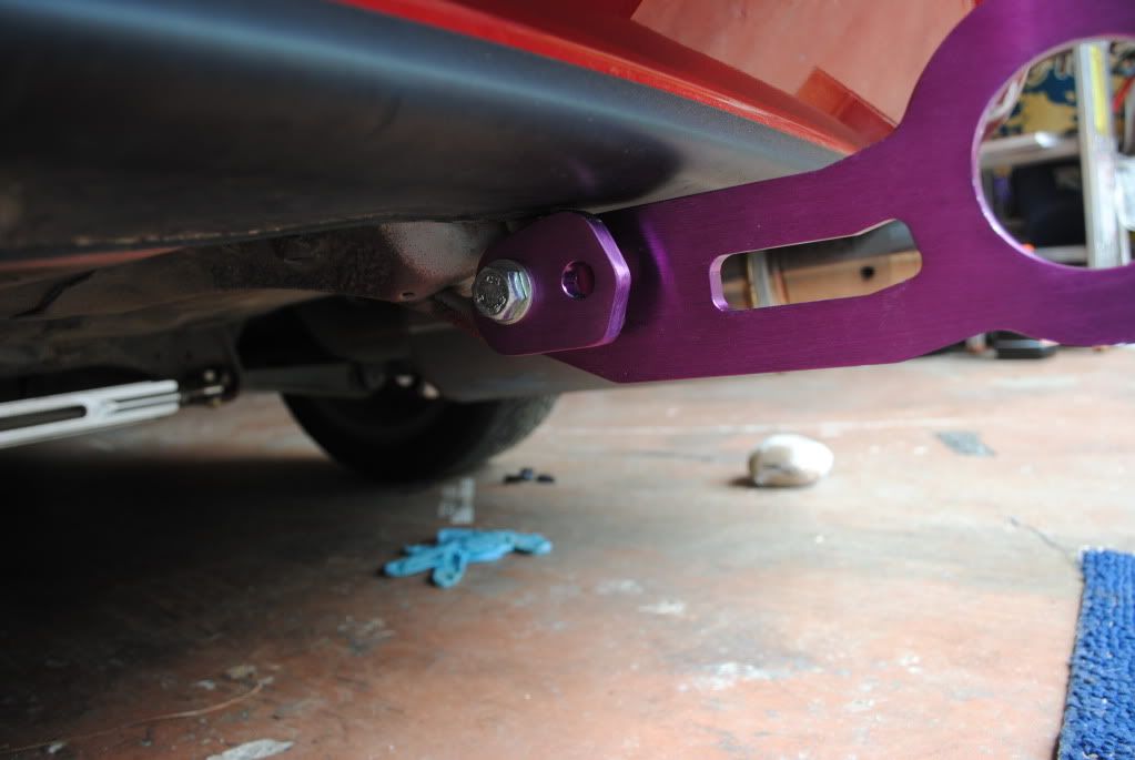

    step2:
    put one bolt into the center of the stock tow hook and screw one hand tight and do the same thing for the front hole just on the outside of the oem tow hook.
    picture:
    step3:
    once both bolts are tight enough take you 18mm box wrench and your 18mm socket wrench and tighten both bolts. i used lock tight during this step, i like to be better safe then sorry.
    step4:
    check over all your work, and if you like torque down the bolts to about 40 lbs.. i did this just because, you can do it if you like.

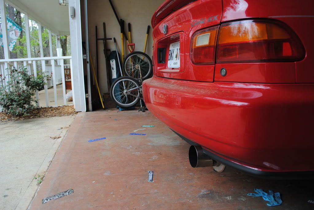

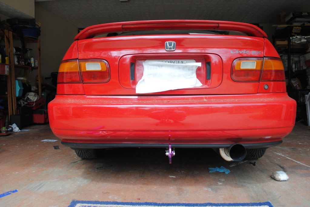

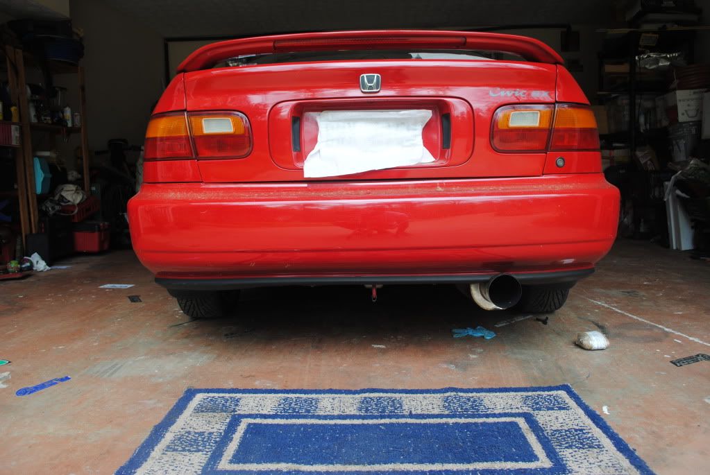

    after tow hook install:
