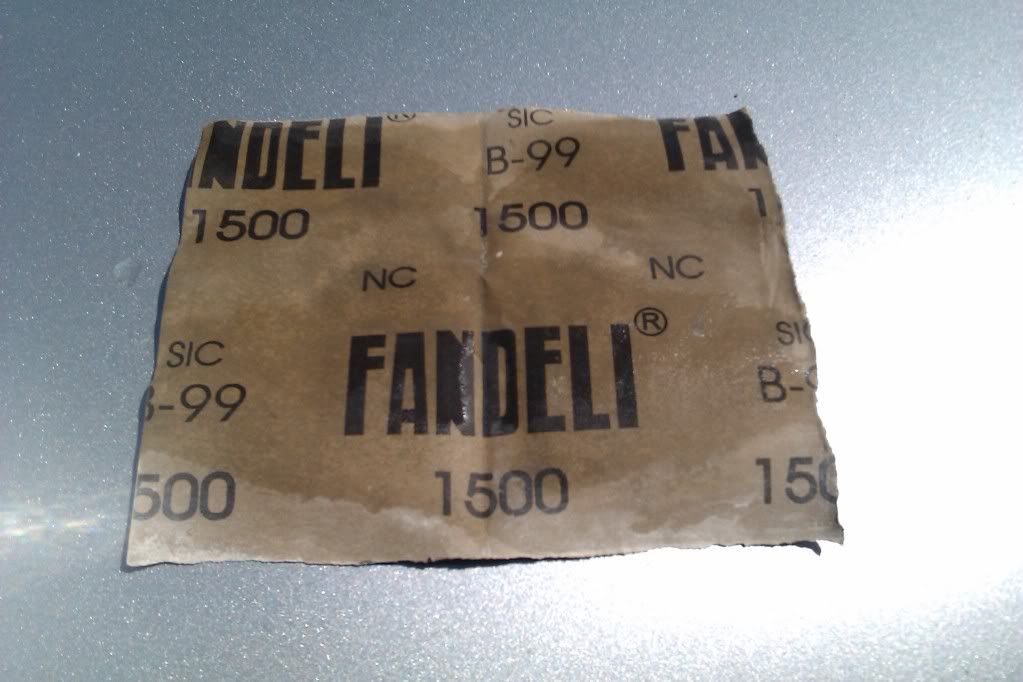

1. Wet sand paper..I use 1500

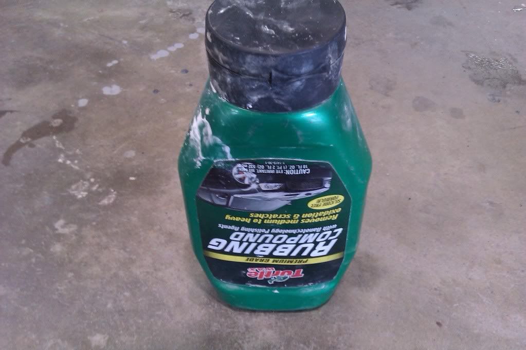

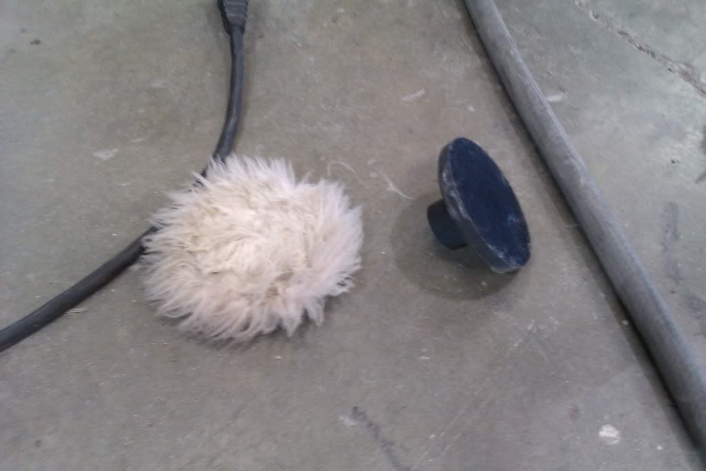

3.buffing compound
4. 3" buffing pad and buffing pad assembly!

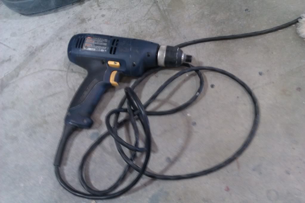

5. Drill

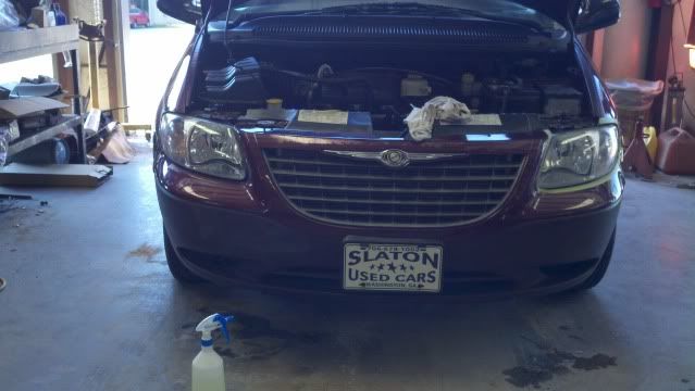

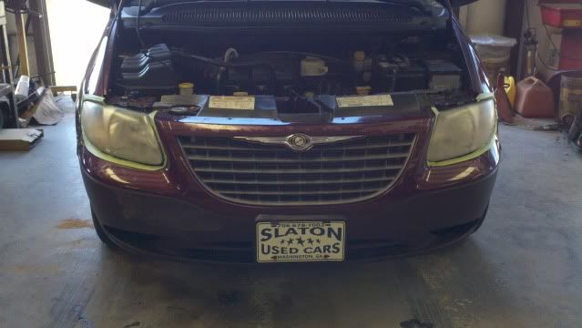

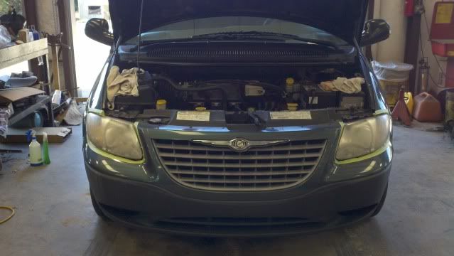

first thing to do is to clean the surface.....

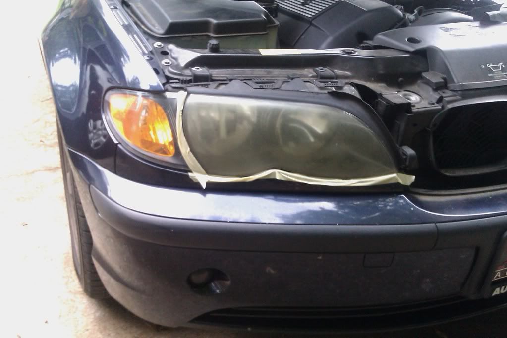

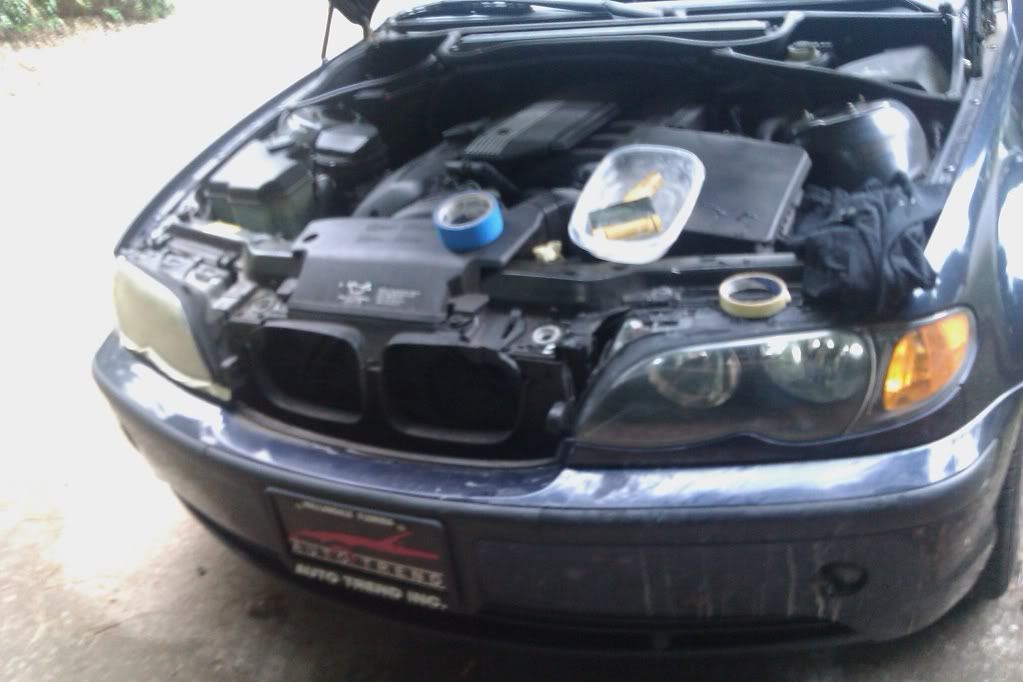

**If you have never done this you may want to tape around the headlights to not scratch the paint of chip it with the buffer!...
Second...apply water to the headlight aswell to the sand paper..

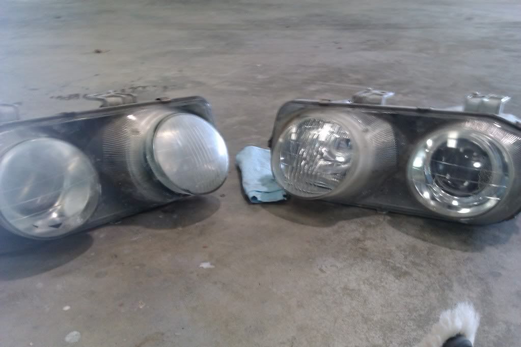

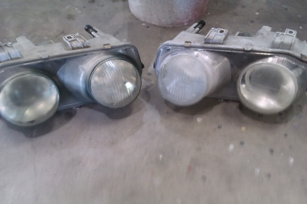

Sand. Down the headlight untill you see it dull white and no yellow looking spots!..

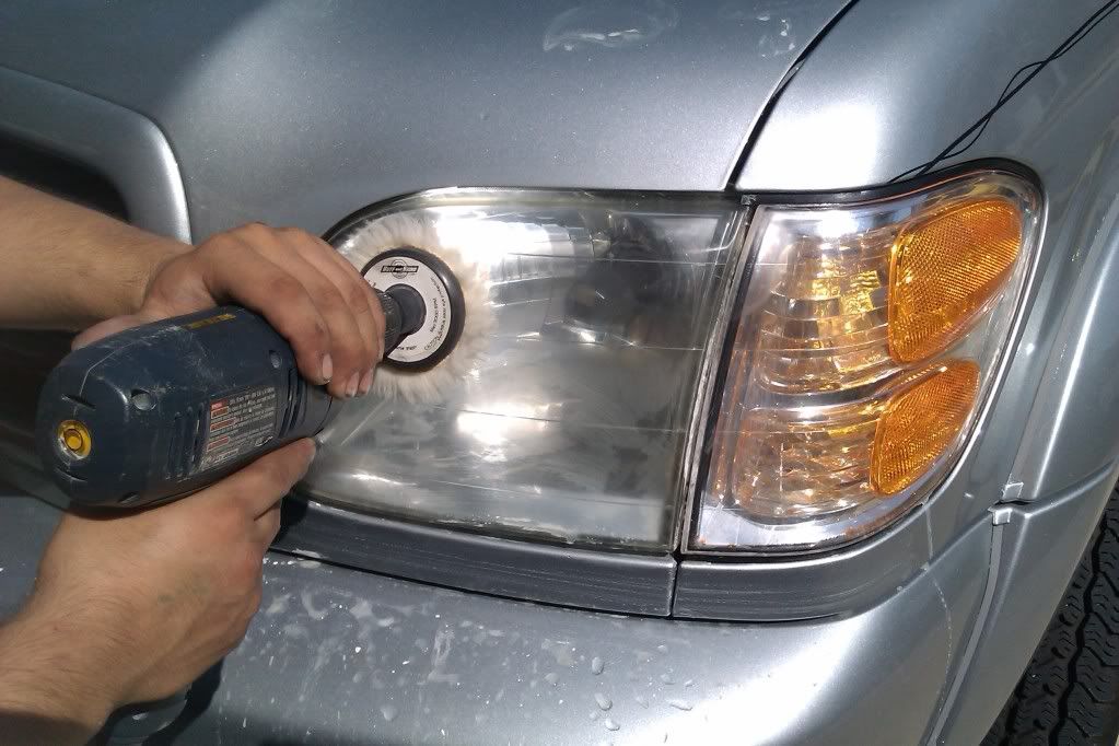

Apply buffing compound to the headlight and start buffing sideways until you start seing the results...

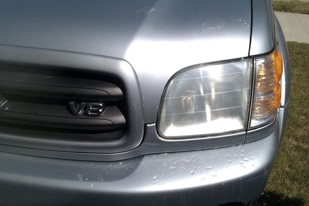

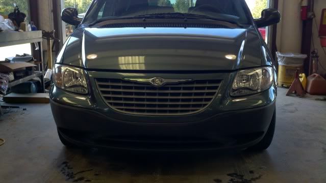

Wipe it down and add a little bit of waxing compound for more protection! And now u have clean headlights lol
