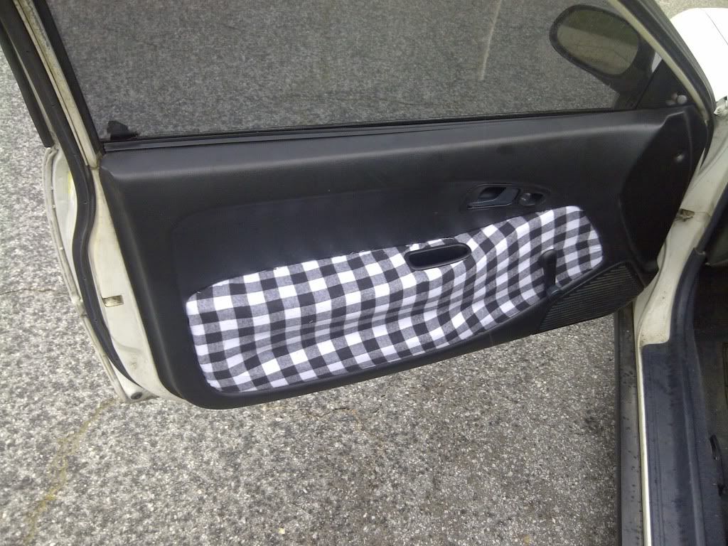

    GD Lee Pitts!!!! 97ITR86's Avatar
    849
    looks good bro. I just did my door panels this weekend. It gives your interior a fresh look.
    849
    Take the door panel off. It is worth it to make everything fit correctly. What kind of car do you have?
