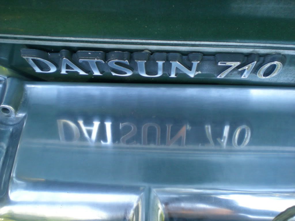

    Its not that hard to do yourself. Steel wool and a pack of progressively finer sand paper is your friend. Don't wet sand, use oil.
    I only spent like 2 hours on this so I didn't get a mirror finish.

    Ive NEVER heard that.. ive done polishing via the wet sanding and have gotten amazing results.. Id like to see some mirror finish results of your OIL sanding method..

    Well considering this is only 650 grit...
    http://i286.photobucket.com/albums/l...n/DSCN2722.jpg
    I can imagine if I had used 1k grit and buffed it at all it would be a mirror finish.

    Neh, that method seems to leave alot of hairline scratches.

    650 grit is going to leave scratches.

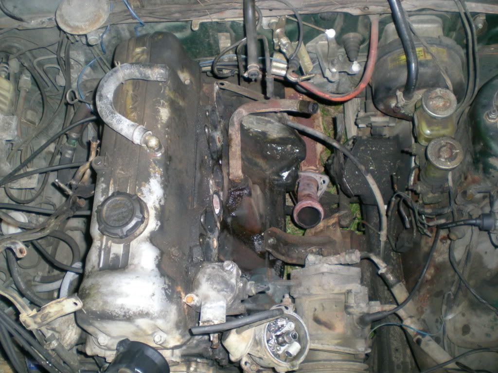

    Before:
    started with 800grit- -1000-1500-wet sand with 2000 .
    after sanding i used mother billet polish. taped then painted. it took about 4 hours. had a mirror finish

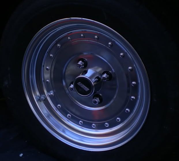

    after:
    never finished these- but after 2 hours of aircraft stripper and sanding i got to here. wheels were black
    polishing isnt hard- just takes time.
