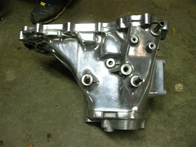

    are you trying to get it to shine like this?

    Quote Originally Posted by allout13 View Post
    yes sir!!!!

    Quote Originally Posted by claybird View Post
    yes sir!!!!
    I hope you look forward to many hours of sanding

    Killing it Since1982 bloodline's Avatar
    new york city
    2,326
    that tranny looks fucking amazing.. im jealous as fuck..i was tryin to clean my tranny the other day wit some purple power.it def. didnt look like that lol

    Quote Originally Posted by bloodline View Post
    The bad part is that he is not even finished.
