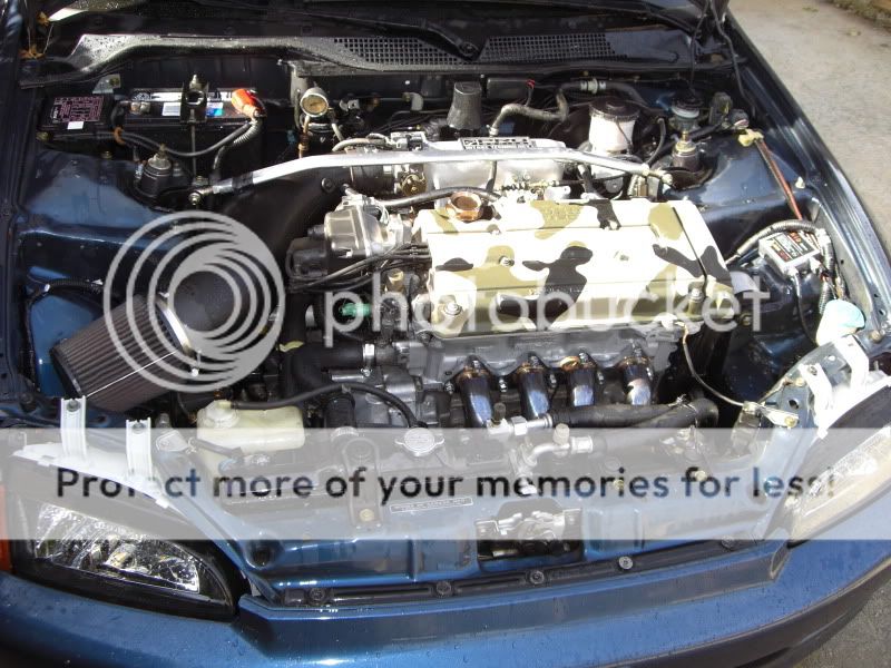

    Here is my steps:
    1. Start with engine cold.
    2. Mix up some 50/50 Simple Green and water in a spray bottle.
    3. Put plastic bags over distributor and intake filter...(this is what I do).
    4. Spray engine bay and engine as much as you desire, I usually soak it real good.
    5. Get a wet brush or a cloth and wipe spots you can to get to.
    6. Spray engine bay down with water hose, keep the water away from the distributor and spark plug wires (I own a Honda so you others may want to use less water not sure).
    7. Take plastic bags off, close the hood and start the car. Let the engine get hot and evaporate all the water in the engine bay.
    This is just what I do... WD-40 sounds like a horrible idea
