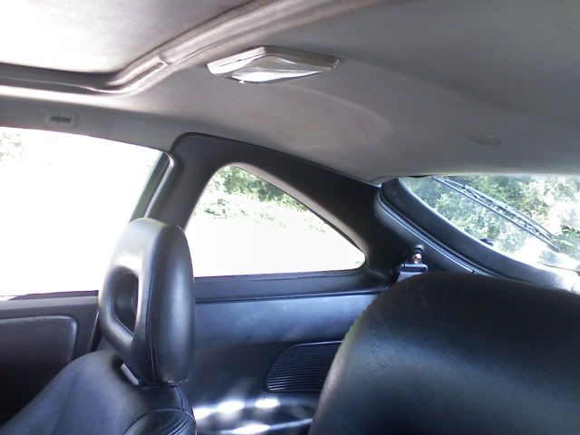

    Preludes had this wierd, Half tan/half black interior. Heres what I did:
    Suede Door panels (just get the fabric, use spray adhesive)
    Suede headliner
    Suede Tweeter pod (also a fiberglassed AEM Wideband)
    Then heres when I redid my door sills. I'm not sure if its the "proper way" but I wet sanded with different grits, getting finer and finer. Then rubbed with alcohol to get any extra wax/dust off. Then sprayed with plastic spray paint. Its for plastic lawn chairs and what not. I sprayed it, let it get tacky, then sprayed again. Did 3 or 4 coats, checked the feel, wet sand, 2 coats, wet sand 1 coat. I did very fine coats. So if you're doing it a bit heavier, you'll do less so its not really thick.
    Also Have a picture of my interior before I switched for black seats. ( I didnt paint them, just all together new.) Oh, Also painted the fiberglassed shifter surround. It has a 7" touch screen, so I basically painted it the same way i did the sills.
