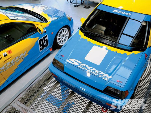

    Just because my car is an NA civic, has no relevance to anything. The engine still produces heat, like any other and that hot air can be released from there by venting. Being on the track and constantly pushing the engine throughout the rpm range, will produce a lot more heat than daily driving. As I currently do not have a vented hood, this is a cheaper alternative.
    JDM Hood Prop - Import Tuner Magazine (they're called facts for a reason)

    reduces "under hood" temperatures by 55%.... why? cause race car!
