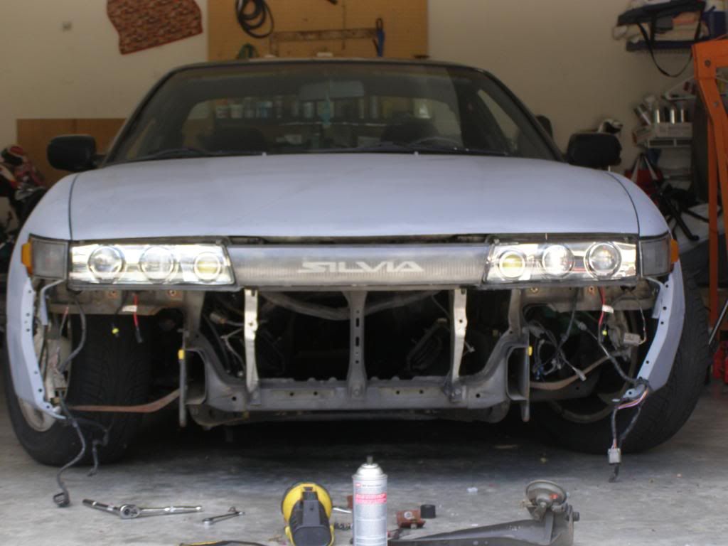

    Been a while since I posted on here. Hopefully my car will be running again sometime soon so I'm trying to get back in to the whole forum thing again and maybe make it out to some meets. Anyway, this is my 90 coupe that's currently waiting for me to finish up a Kade swap. Basically just want to be able to drive it while I save to rebuild my SR.
    Front
    Kind of a side shot
    Interior pre 350z seats
    Work shot
    And last up, my super sweet valve cover
    Like I said, it's a pos. Not even going to begin to list the shit that's done to it unless someone is really dying to know. To sum it up its basically an s14 with an s13 body.

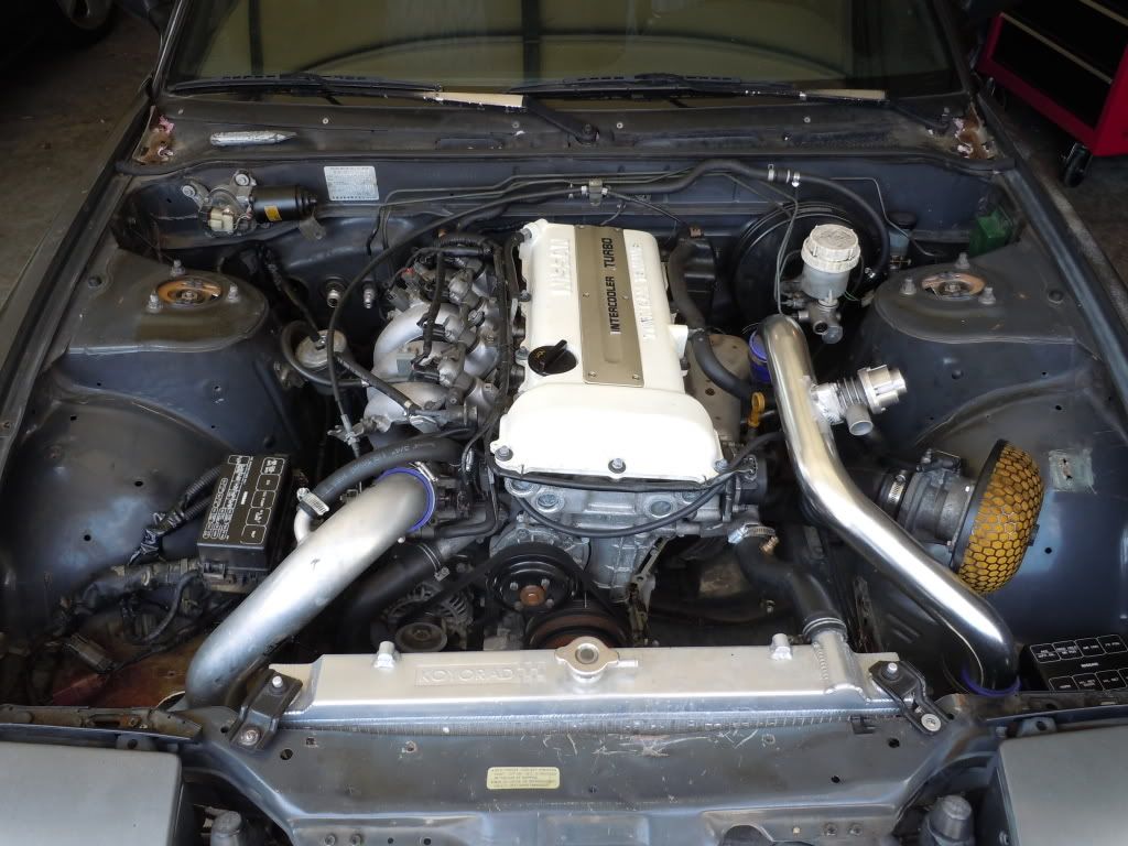

    i'm curious as to what makes it a "s14 with an s13 body"
    Full rear s14 subframe swap. Front lower control arms, spindles, hubs, etc are all s14. Engine is a 96 kade. Also has s14 carpet, the stock s13 shit is absolutely disgusting. I ordered an egr block off plate and stainless clutch and high pressure power steering line on Black Friday. I'll update this thread periodically I guess.
    Just for shits, here's a couple shots from when it had the sr. Popped the headgasket which is why it's going to be rebuilt.
