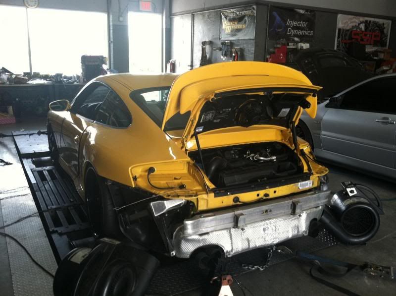

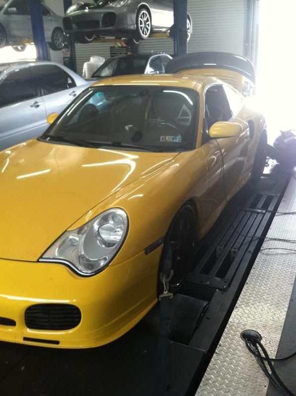

    On the dyno

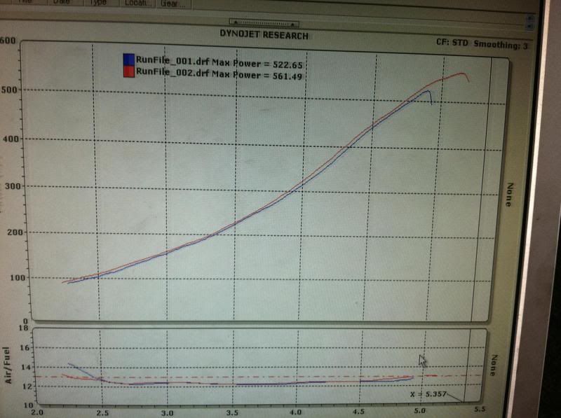

    Numbers at half boost, 93 Oct. ran out of injector. 60lbs injectors went in and boost will be cranked up. Shooting for 640-650 RWHP on pump for a kick ass DD.
