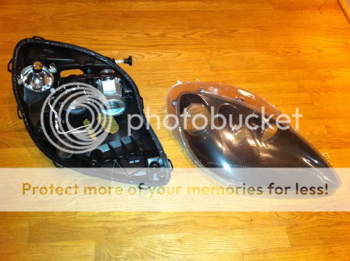

Tearing it up! Excuse the iPhone pic. It gets better I promise! The old lens looks worn and tired anyways. So good thing we have new ones!

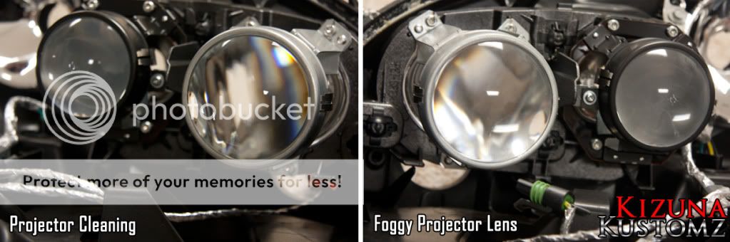

Cleaned up the projectors while I was in there as a courtesy...Look at the difference!

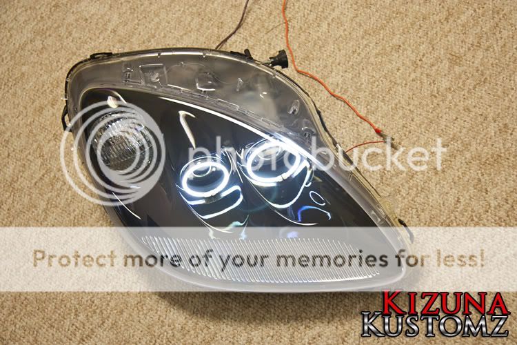

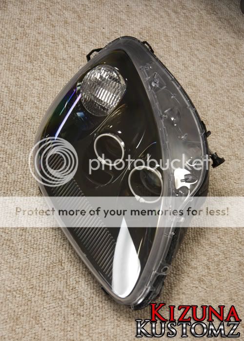

Halos installed, preliminary check of fitment and placement of inverter. New lens installed making the headlight look brand new.

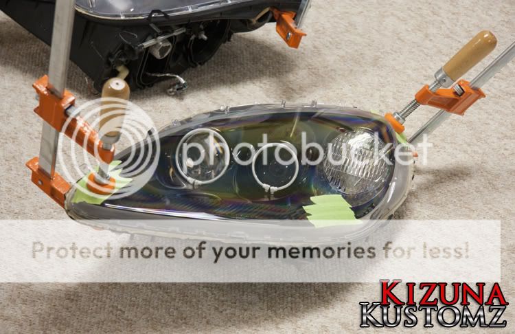

Sealing it back up!

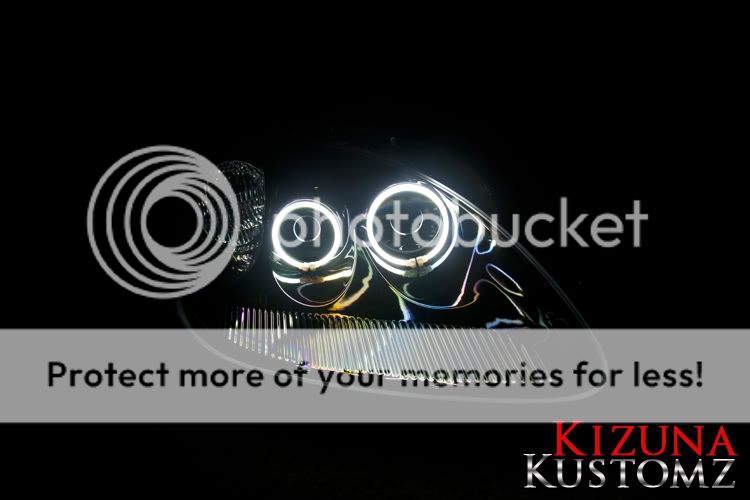

And of course here is a night shot. These are bright! These halos are in the 6K flavor. I can get almost any color. Just ask
